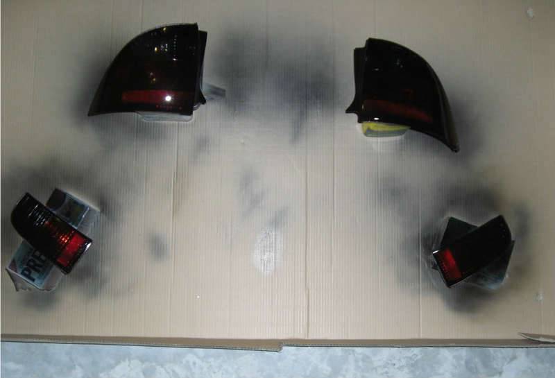

Prep..

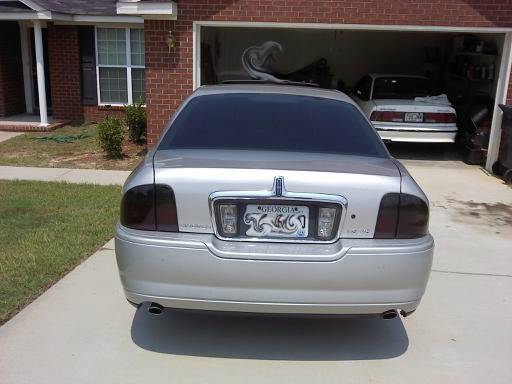

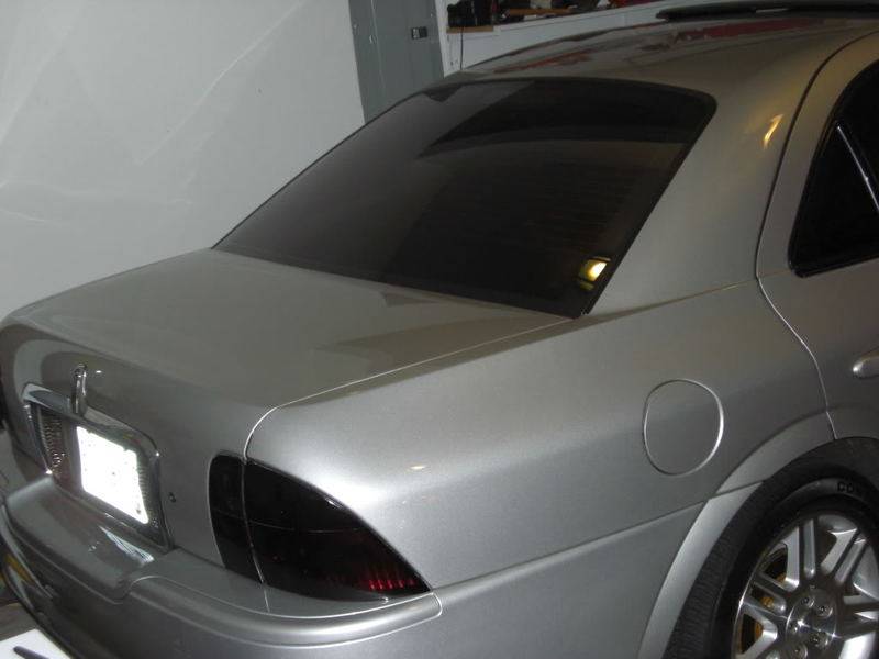

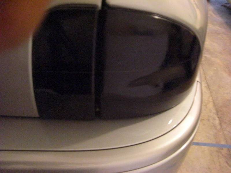

End result … It came out well… looks like a pro did it lol..
Thanks guys…
anybody tinted theirs lightly? most i see are pretty dark. I was thinking about doing just a light coat.
Looks great!! I have a the same color LS as you and I wasn't sure how it would look. Now I know what I will do this weekend. :)
thanks seekonkholen1..
more pics please.... you sand and clear coat?
I’ll post more pic’s of the Sbullet in the sun tomorrow…And yes I did 5 coats of clear, 3 coats of VHT Nite Shade. Used a 2000grit sandpaper…. Sanded before spray…. Sanded after clear coat…. And used a microfiber cloth and applied 8 application of Meguiar’s scratch x to bring that shine….. I basically followed this guy’s instructions step by step
