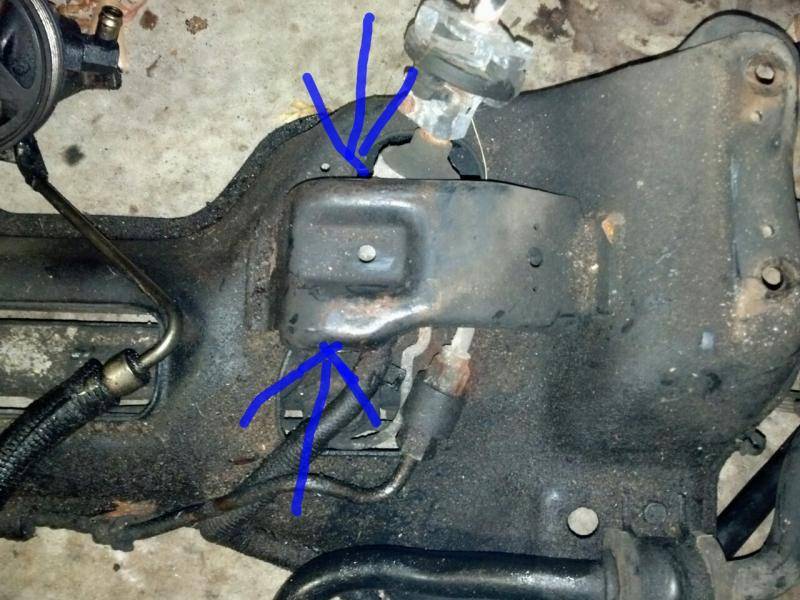

Nope couldn't find it all I see underneath is k frame I don't have to take that off right
Drivers side bolt goes through here
Finally got her put back I want to thank everyone for the awesome advice the motor mount trick worked like a charm
