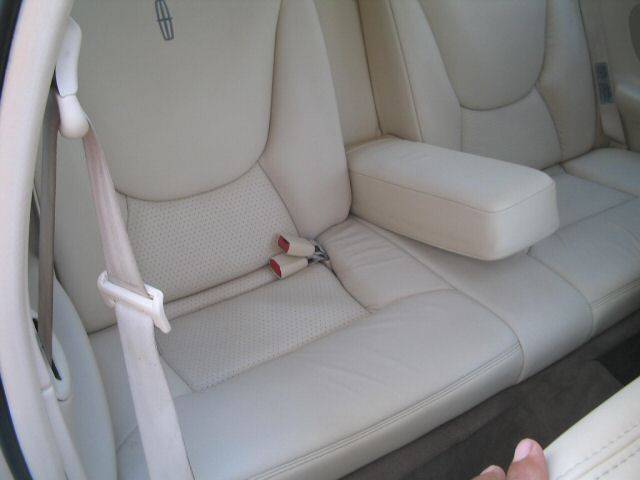

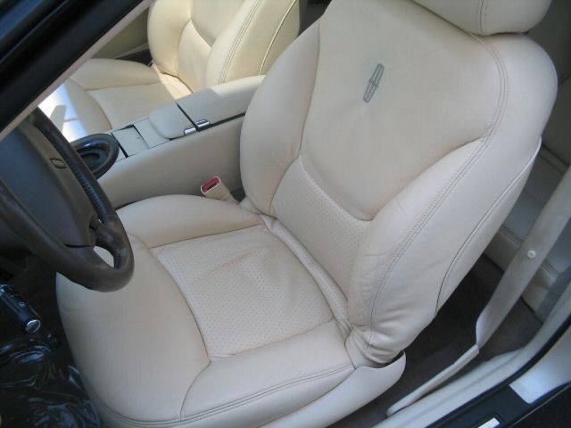

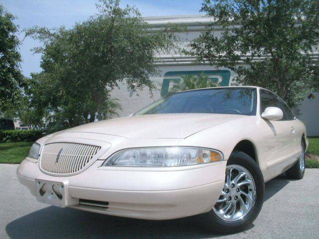

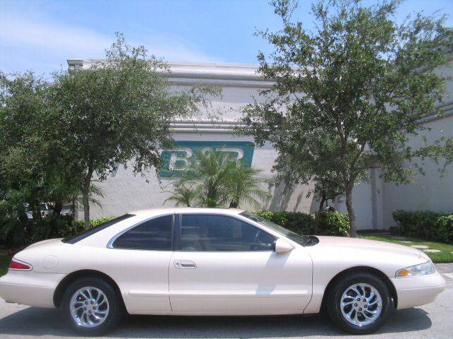

Update....
Well I'll be coming home from Iraq in a couple of weeks and on the first of december I won an Ebay auction for a 98 Mark. :D Many mods to follow.
Very nice LSC there. I want a Gen II even though they are slower then our 94.
