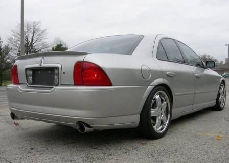

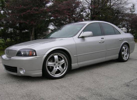

Here is what the 04-05 LSE's typically look like. (Mine just has 19" wheels, lowered, and the McLaren grille)

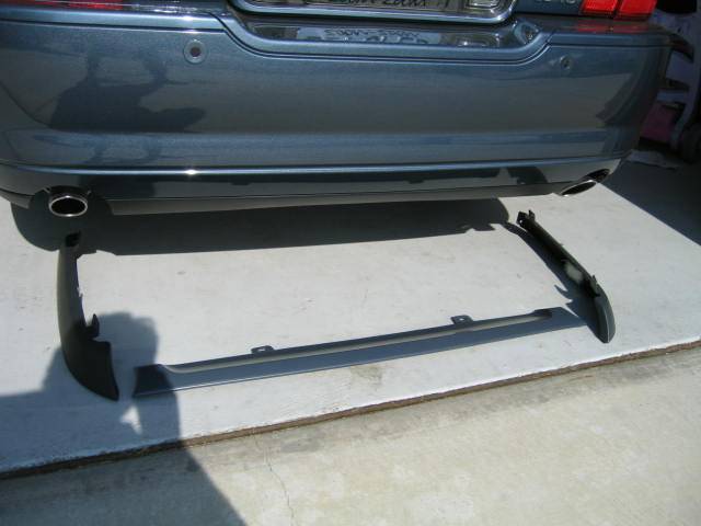

Ok guys have a question for those that have done the later '03 up change to lse style .
I got my rear valance piece for a 06' and I noticed the outer pieces have 2 extra tabs on the lower part of them ...anyone else run into this ? Did you just cut them off ?
Those of you w/ a 2006 on your rear lower outer valance pieces ....what do the lower mounting tabs bolt up to ? Anyone got any pictures ?
thx
Those tabs are important, do not cut them off. You have bend them 90 degrees. I set mine out in the hot sun and then it was easy to flex them. I got the original rivets for the side valances from Bill at team ford. The rear valance uses the existing 2 large bolts.
I guess then its sufficent to say ...don't paint the tabs or the paint will crack when you bent them .I'll just heat them up with a hot air gun I guess
Do they rivet up to something ?...the floor , shields ? I haven't looked under the car yet as its raining here ......
