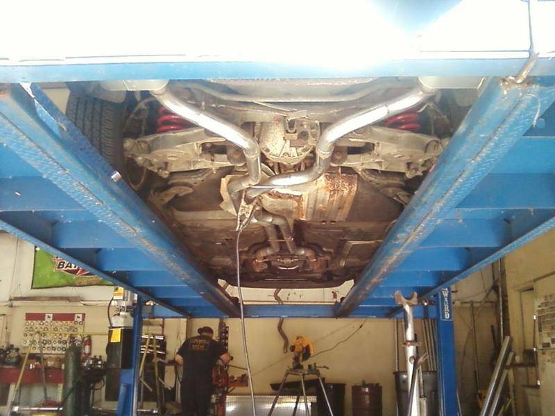

I think some place may offer a complete kit if you want catback exhaust, but that's big $$$; if it's an LSC it has true duals already, if not you can get a muffler shop to mod it; or just replace the mufflers, Magnaflow XLs sound good imo
rims?I've seen some guys with 18s...dunno about 20s; it's an odd spacing size...5x4.25" so many of us hub swap to 5x4.5" so as to use Mustang/Cobra rims

yes, true duals can be created, the tricky part may be finding a shop that's willing to remove the '3rd cat';
for the fronts we use a mustang hub/bearing assembly, pretty simple; the rears have to be redrilled (with a jig)
for the fronts we use a mustang hub/bearing assembly, pretty simple; the rears just need the Mustang Hub pressed in with a new bearing
