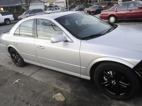

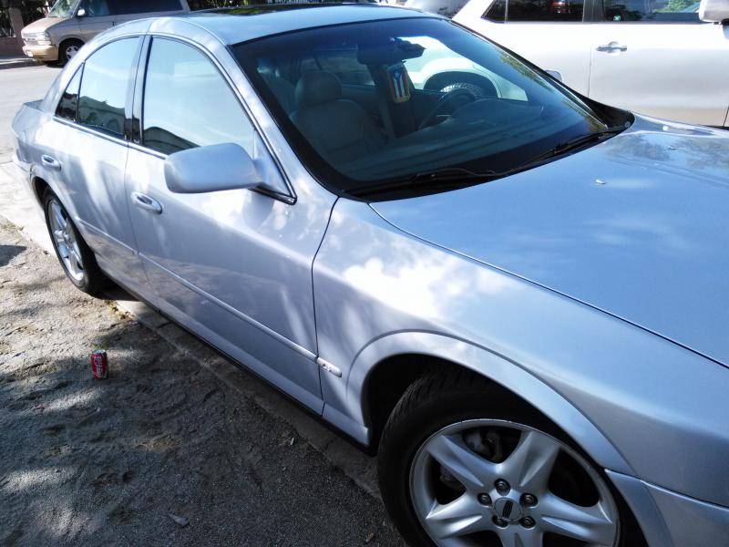

Hey thanks for replying, so I have a 1999 V8 premium audio all leather very little wood trim advance track all silver no chrome besides for both grills 17 inch wheels that I purchased a few months ago with only 96,000 miles very nice IMG_20150614_172954.jpgso far I have added a few personal touchesIMG_20160216_175702.jpg, I have read mostly every post I could find about installing a supercharger or a turbo they all sound so discouraging about it the turbo looks easy enough to install ,the supercharger a little more difficult until I found this posting( http://www.bangshift.com/forum/foru...remote-mounted-m122-eaton-roots-blower).I.d.k. what's your thoughts.
