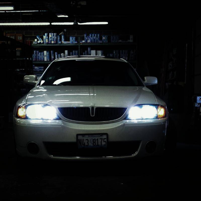

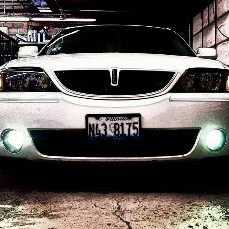

here are some pics of my set up , light output is no issue
