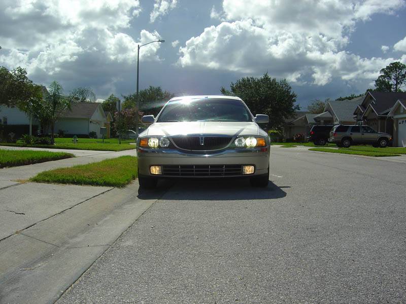

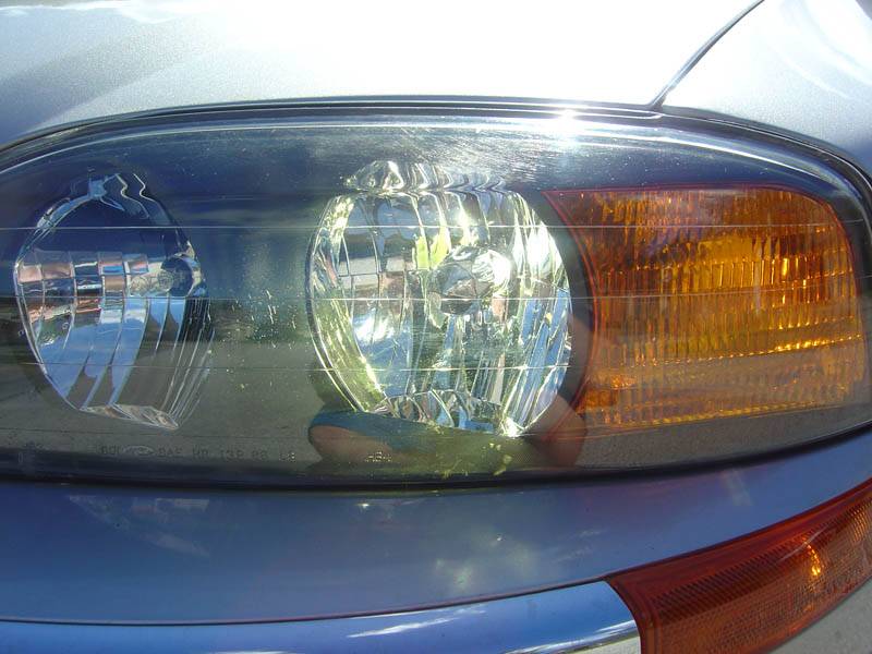

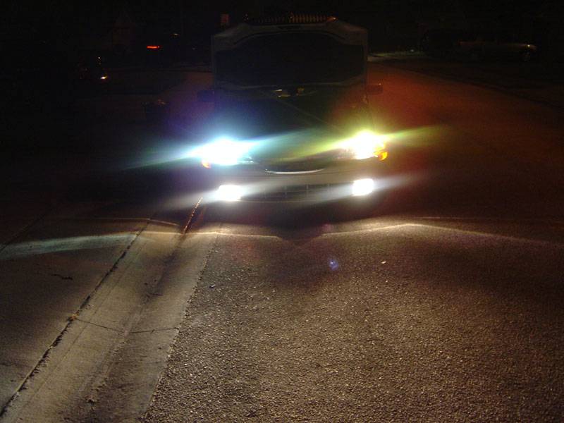

OK so I finally got the nerve to buy some HID's I bought a set of Philip Xenon on ebay for 265 shipped (great deal) After looking around everyone said get 4300k Well these are 5000k (pure white) there are F***ing sweet I love them so much I drove a Little tonght and damn its nice to see Tomorrow I have a long early rode trip and after EMT school long ride home in the sticks so now I got some pics to show and I will take some out in the dark thru the window letme know what you think.....also I have a question if I want to getting some 8000k or 10000k for showing off at parking lots or shows all i need is the bulbs right thanks

You can swap out the bulbs if you want a different color range. One thing to recommend is that you may need to aim your headlights down a bit lower than stock. The HID conversion kits have a lot more glare than the regular halogens and you don't want to blind oncoming traffic. Also, remember that the HID conversion kits are illegal to use on the road according to DOT so just keep that in the back of your mind.

Ok yeah I was looking at that just a minute ago how do I move them down (is it the screw inside the cover with the level and also the one on the back to move it in and out how does it work (i think mine is broke on both sides) it almost looks like there is super glue (I bet the guy how tried to seal my lights up broke it and thats how he fixed it ) the drive side light points so far over to the other side If I discont the pass one you cant even see that is off it looks like the driver is out!! let me know

Well I found a dark road with no street lights and adjusted them I had to move the UP and out the light was not much further then the fog lights and was right in the middle now I can see everything and They are good drove home and nobody flashed me (it might be a hair high)

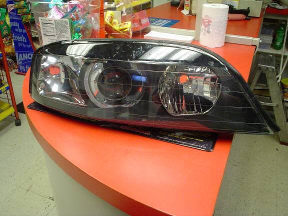

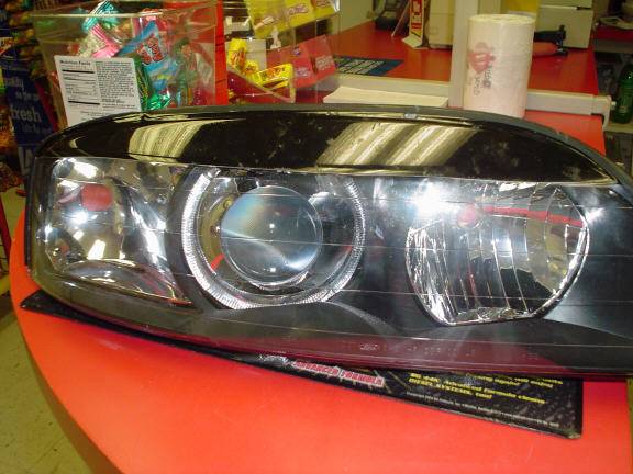

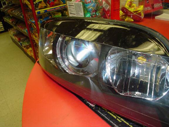

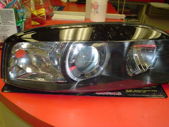

It isn't that hard to retro some projectors in there and they look factory when done right. And your light output will be even better because it will be all focused on the road with a nice beam pattern if you are serious about it the guys over at http://www.hidplanet.com/forums would be more than happy to help. Below is some pictures of a retro

Those are actually of one of our members headlights. It's Jay (aka Akkord29). He had the projectors put in those headlights by one of the guys on the HIDplanet forums.
I'm sure Jay will chime in on the price he paid for them. I wouldn't have a clue. However, I had a set of projectors that I was going to try and put in a set but realized real quick it wasn't going to be easy. I put a set of angel eye rings in a set of headlights that had those on there and it was pretty detailed. I sold the projectors and got the 2003 and up OEM HID headlights instead.
