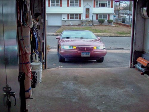

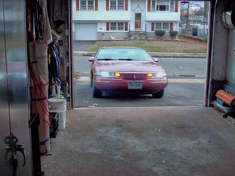

HID LED 95.jpgI got a kit from HIDGEEKS about 2-3 years ago. 8000K--75 watt, about $65, no relay wire snipped. Never had any problems.

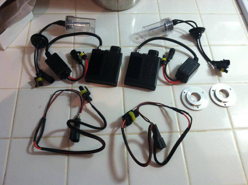

Here's one of the kits I've put together in the past. It's not immediately obvious in the picture, but you can see the OEM Ford plugs soldered onto the aftermarket HID harness that comes with the kit, towards the bottom of the picture.
That's one thing I regret not doing the first time. Makes for a much cleaner install.
