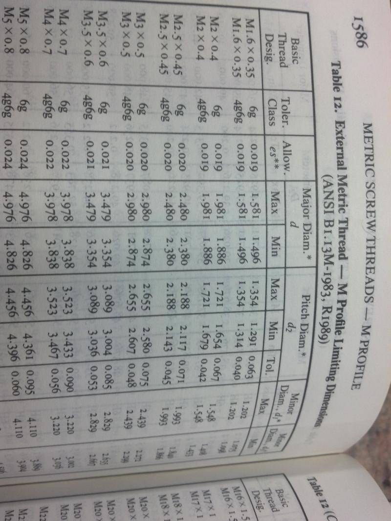

What pitch? What width?
There is only one m3 at least in the machinery's handbook 24th edition
M3X0.5
