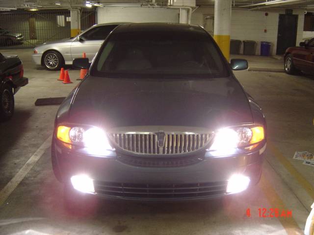

One of my HIDs doesn't work, so I hooked up the harnesses of lowbeams to the highs and now I have the euro BMW effect. I think looks good. I might put the HIDs in the highs and run em like that when I get em.
I am gonna go snap a picture now.

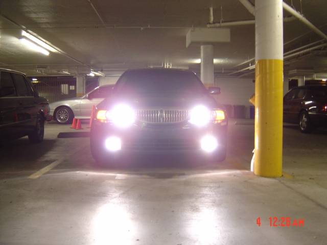

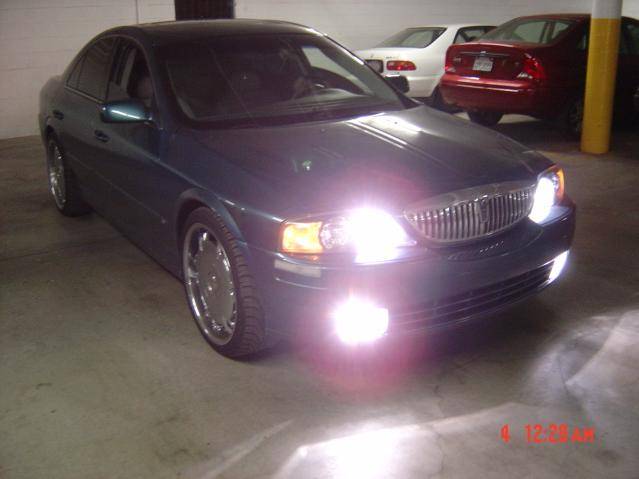

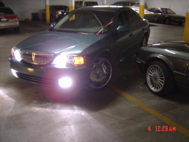

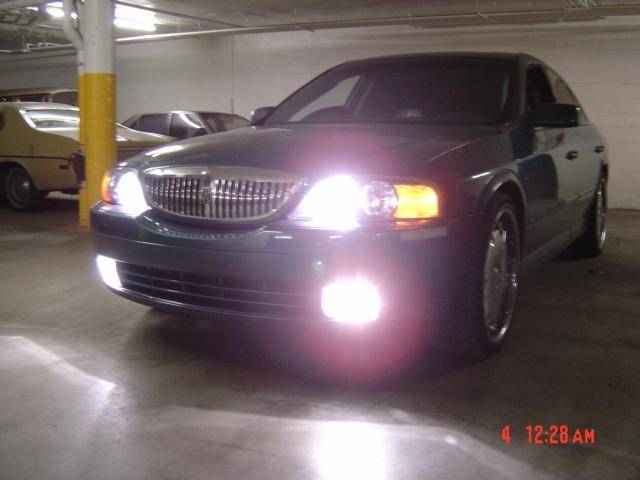

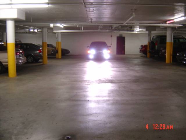

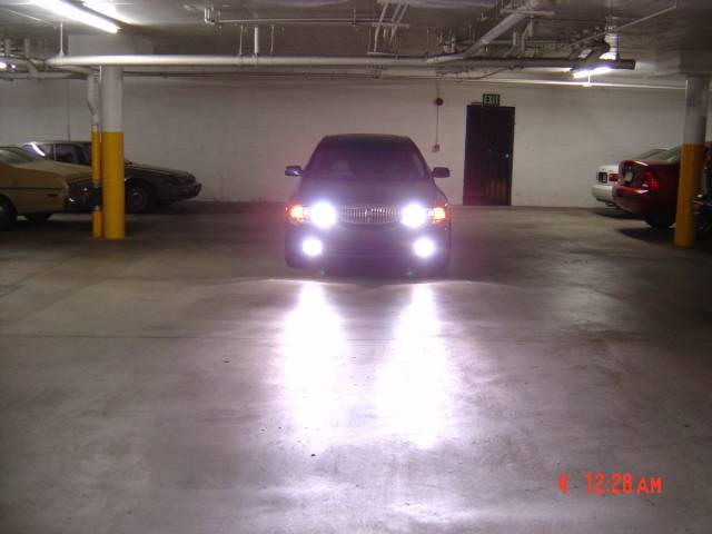

Here are some pictures. The car is really dirty, it's raining you know
Yea and I did lower the high beams.
On the 03+ models the high & low beams are on together. The fogs & low beams are on together. No more than 4 lit lights to the front of the vehicle. Your local law enforcement may or may not enforce this, but in any case, more than 4 lights on to the front gives them a reason to stop.:)
that's an HID thing...remember hid's don't hit brightness quickly so car's with HID's normally DON'T turn the HID's off when the brights are on because when you switch back to low beams there would be a delay with poor or possibly even no visibility.
You are right. The nice thing is that the 03+ are all wired that way, even if they did not come with HIDs originally.
