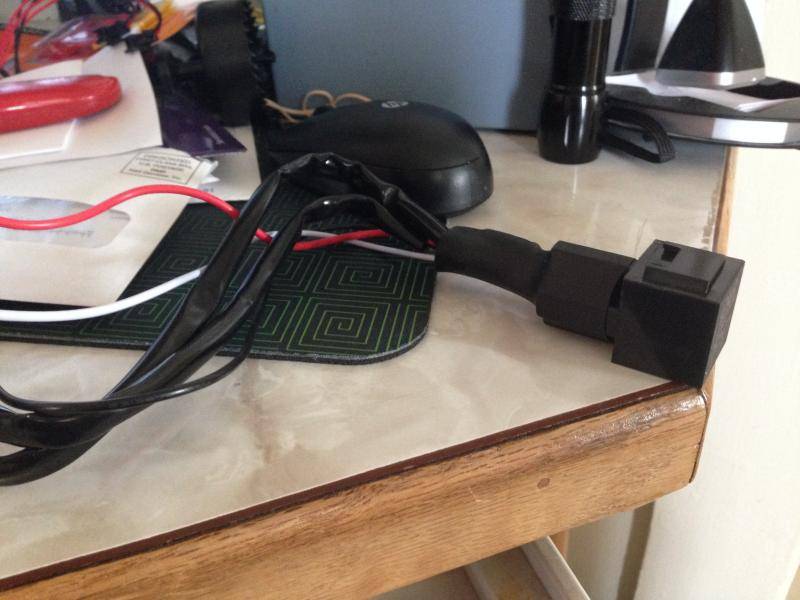

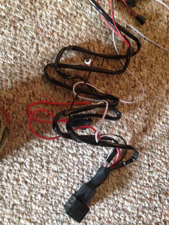

It's a harness that came with the box, it has a relay and positive and negative ring wires. Has some other wires also. I think it's a harness to wire the eyes as daytime runnin lights. Or to make them into a switch to turn them on and off.

You could wire the positive to the headlight positive feed, and the negative to ground somewhere up front. Then, they would be on anytime the key is on, and wouldn't go off until about twenty minutes later. They would also come on when you unlocked or opened a door or whatever.
Hey Cronos, that sounds like the same harness I have how did you wire it in? What wires did you use? 007.jpg008.jpg
