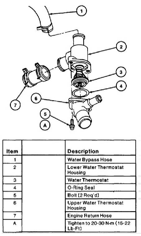

You have to undo the clamps on the t-stat housing. Undo the lower hose.
i know where i want to drain it from, i just done know how to get that clamp off, it's that strangest thing. i was expecting a regular hose clamp not that thing
Use some vise grips to remove the clamps. Just pinch the ends together.

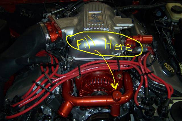

I also used the drain plug on the bottom of my radiator. Remember to refill the coolant through the cross over tube in front of the alternator.

i got it off and done, i have no spicket like people talk about, i have a 93 if that has anything to do with anything. now the problem i am having is filling the radiator back up
Use this to fill the block, It is removed by a 1/4" drive ratchet. This will also fill the radiator. It has been my expierence, to replace the o-ring(coat with di-electric grease), and teflon tape around the threads. This will insure you don't have to worry about leaks.
Your local hardware store will have the o-rings, and your parts store will have the di-electric grease. Be sure to squeeze the radiator hoses to "burp" the air out of them. The 4.6 is VERY sensitive to proper fill procedures, and must be done right or air will remain in the system causing a potential overheat.
