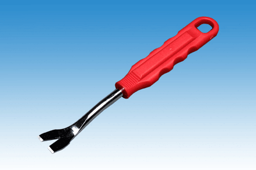

You can spend a few bucks, and just get one of these.
or get one of these for less:

easiest thing to do, I found, to gain a better fulcrum pivot is to slide the V-shape under the button head, and then use the handly of another screwdriver under the clip removal tool's "pivot point" to gain a better fulcrum angle.
