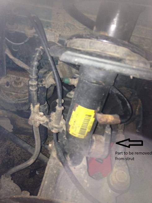

Hello Everyone,
This post is a continuation of a previous question regarding a broken front strut. With help of the forum, it's clear I need to replace the strut. I've managed to track down a Ford shop manual showing me how to do the job, but they love to use the phrase "remove part...." Well I have no idea how to remove the part. I've attached a photo with an arrow pointing to the part I'd like to remove. It looks like it may un-screw, but the connector and wires appear to be in the way. If anyone has experience removing one, would you please give me some advice.

Does that rubber (?) piece at the arrow snap off away from the metal part? It looks like it may be covering a fastener. Total guess on my part though.
It looks to me that you unplug the wire at the actuator or further up the wire and the shock control actuator should be on your new part and you just plug it back in. The service manual does mention if the actuator is damaged you replace the strut/shock.
Do Not Remove
Thank you! I looked at the part very closely and it says clearly "do not remove"
Going on your advice, I started following the wire that came off the strut and found a connector about 6 inches away. After a few tie-downs it was free.
