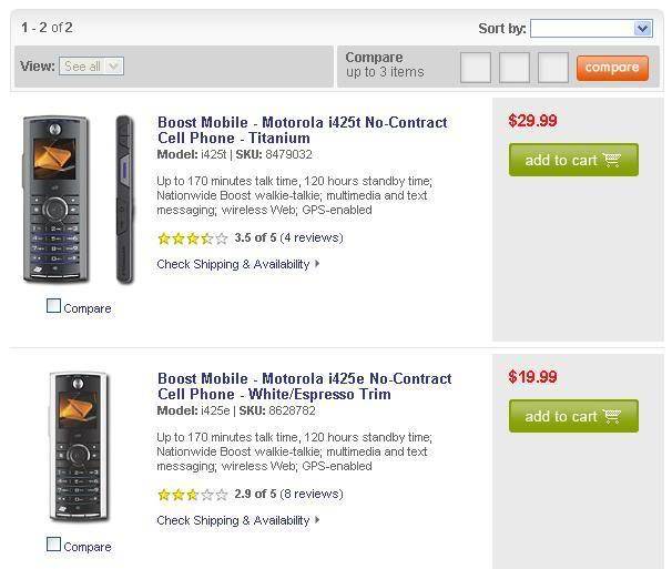

Go to bestbuy and buy a boost mobile phone. an i425 (E or T, they are like the same thing)
Open up the phone and activate it VIA THE WEBSITE and make sure you uncheck the box that says wireless web access or w/e make sure you uncheck ANY EXTRA :q:q:q:q so you dont get charged for it.. the phone should come with a 5 dollar card and that should last you 90 days..

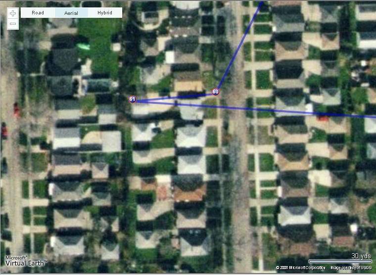

heres a pic of my buddy parked then in his driveway 1 minute later...

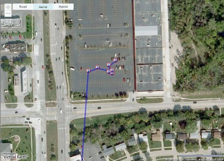

and heres one of him in a parking lot waiting for someone...

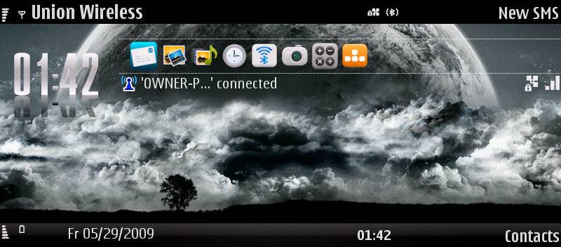

i just noticed the time on the pic and i dont want to scare you or anything but i'm in the future...like 2 hours into the future
Pffft. Wait till my time machine is out of the shop. I'm having a new googoplextinator installed. :D
