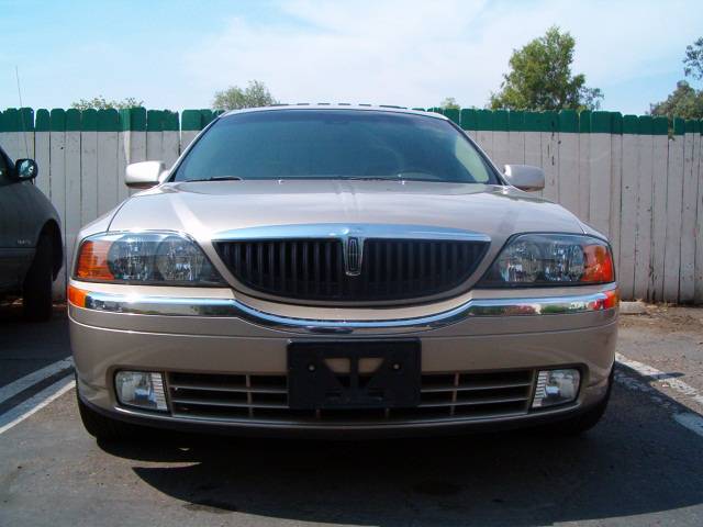

WOW! Looks great... It's pics like these that make me what to throw caution to the wind and try it myself.
