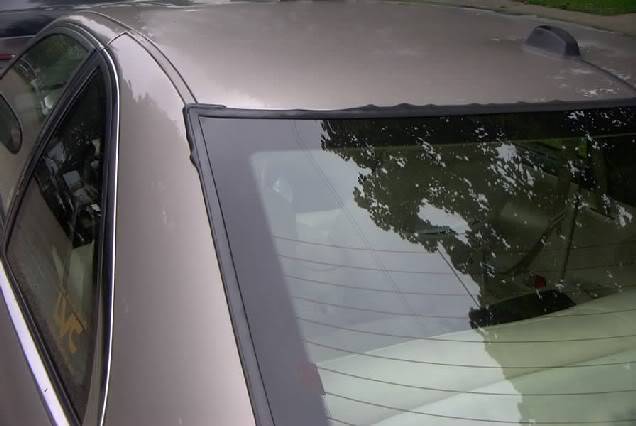

Does anyone have any suggestions on how to deal with the "lasagna" look of my rear window molding??? I heard that replacing it would be very expensive. Any help would be appreciated.
Only one real way -
Buy a new back glass unit.
I have heard of some people trying to glue the trim as well, but I wouldnt try that personally.
I used 3M double side sticky tape under mine and pushed on the bad spots and it layed down for quite a while...like a year or so

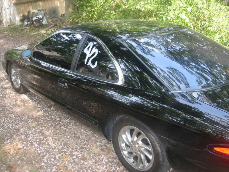

I just took a plastic knife, like one of the ones you would get wendys or whatever and pushed the rubber back so it folded into itself and went in the groove...you really cant tell except for at the end of it and who cares, looks WAY better and was free.
Cant beat free...besides whos lookin at the trim when our cars look like this anyway? lol
Thanx for the tip. Mine has been sitting for a while now and got worse. It is dry rotted and starting to split. I guess I am going to have to bite the bullet and get a new window and molding. Then I won't have to f**k with it for a while:)
