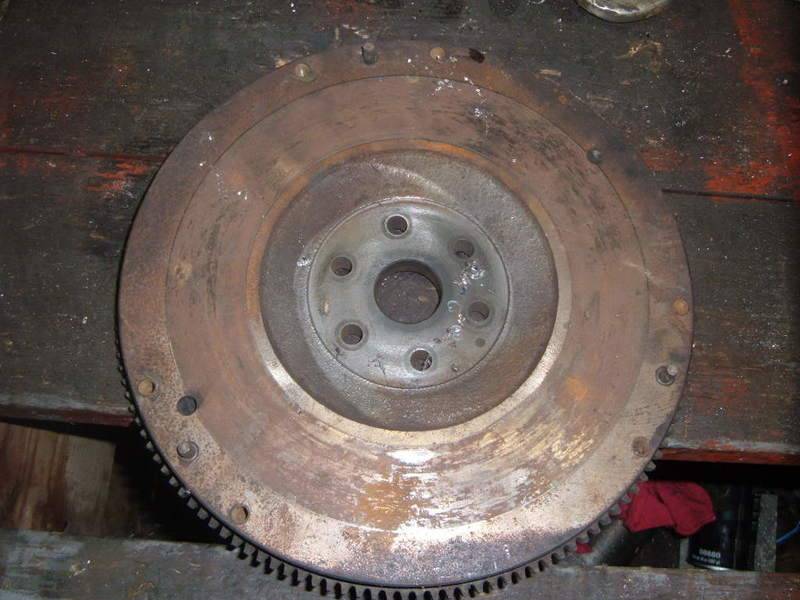

Start with your stock flywheel, In my case, 2.3L Turbo Ford
Its weighs in at 20.5Lbs
Lets see how much weight can be cut off….

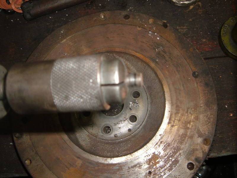

Next is to remove the clutch plate alignment pins….
A slide hammer works well

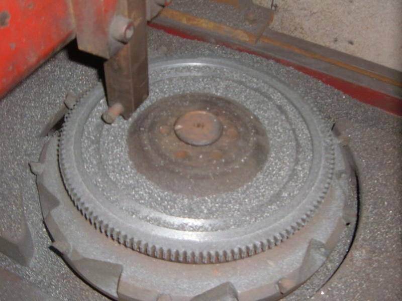

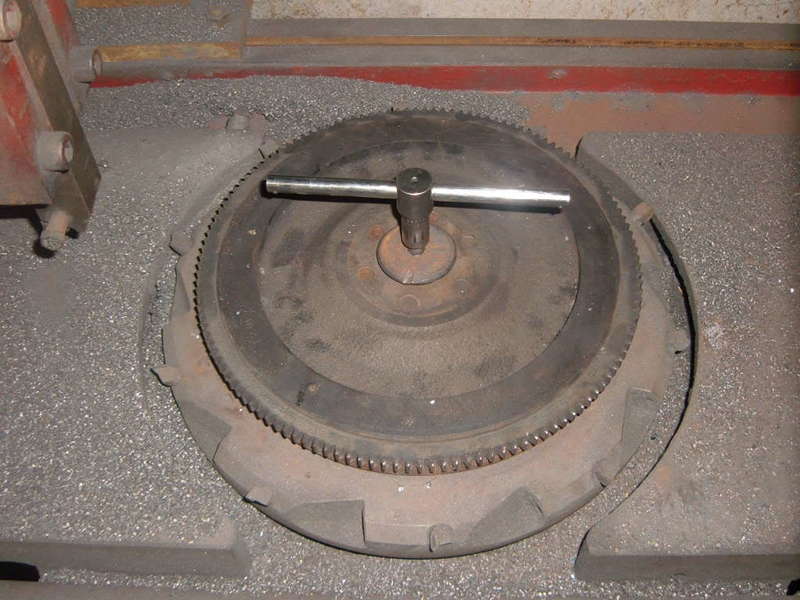

Mount the flywheel upside down, on the flywheel grinder

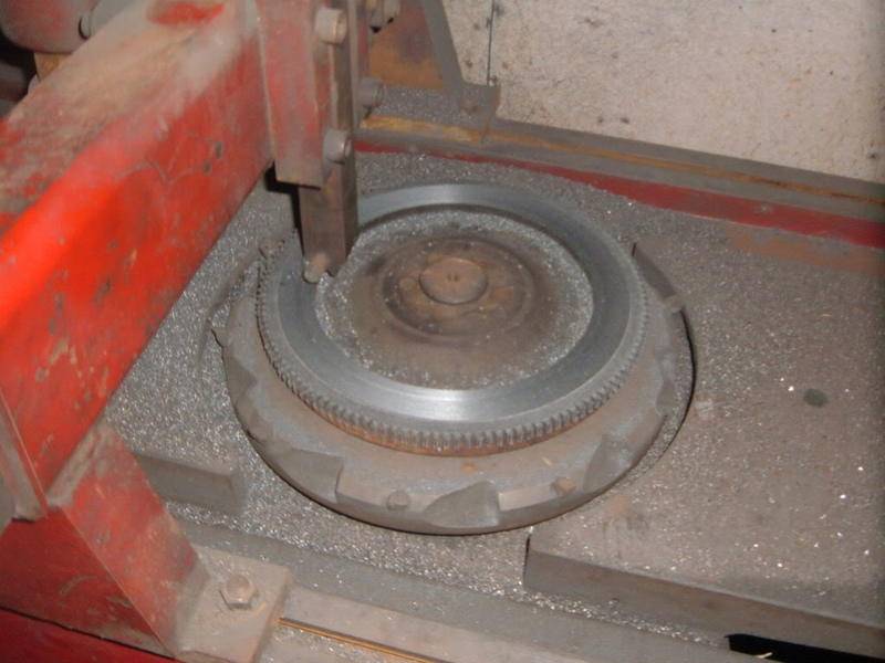

Start buy cutting the excess cast iron down to the ring gear..
Once that was flush, I weighed the flywheel again, that reduced the weight by .75 lbs (12 oz) now 19.75 lbs
Time to thin the fat from behind the ring gear…
each pass, this machine cuts only .005-.008 off…
the final weight is now 17.75 Lbs
I removed a total of 2.75lbs…. This should help the engine rev a bit faster, with out giving up too much torque..
