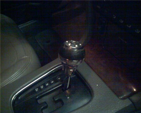

How do you remove it? My car has a couple "ricey" items that were installed when I bought it. One being this aftermarket shift knob, "oklahoma chrome" spray painted air conditioner vents and calipers. :yuck: Also, some fake carbon fiber looking door handle bezels.
The car was a good price so I overlooked these items. I bought some vents from a junkyard and painted the calipers red, better than the "chrome" I suppose. The aftermarket knob will come off easy because someone modified a manual knob. I found a dark gray leather wrapped handle, which is the color of my interior, at my junkyard and want to know how to get it off. I want to "de-rice the auto."
If its like the stocker in anyway see if that funny cone shaped piece below that hideous knob pulls down. If so you would have a screw under it. simply remove it and pull it off.
Right. This cheapy on here is a snap to remove, but the stock knob looks pretty tough to pull.
Seriously-its that easy. Pull the bottom ring down and you will see a screw.
