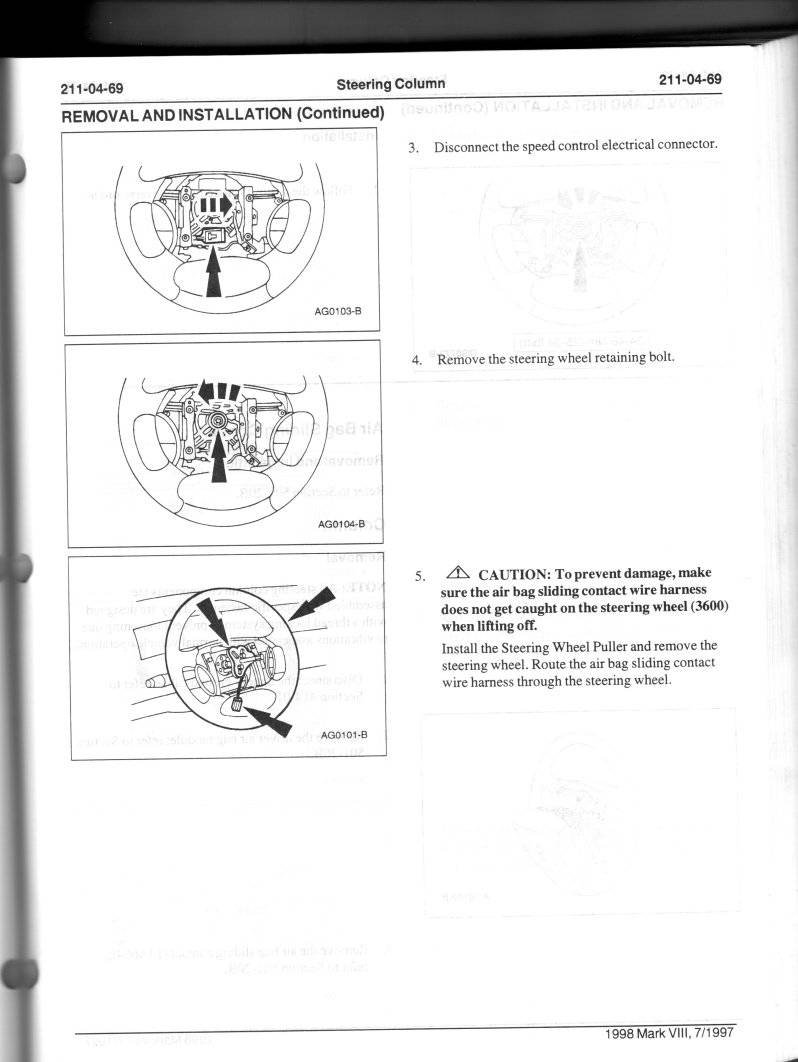

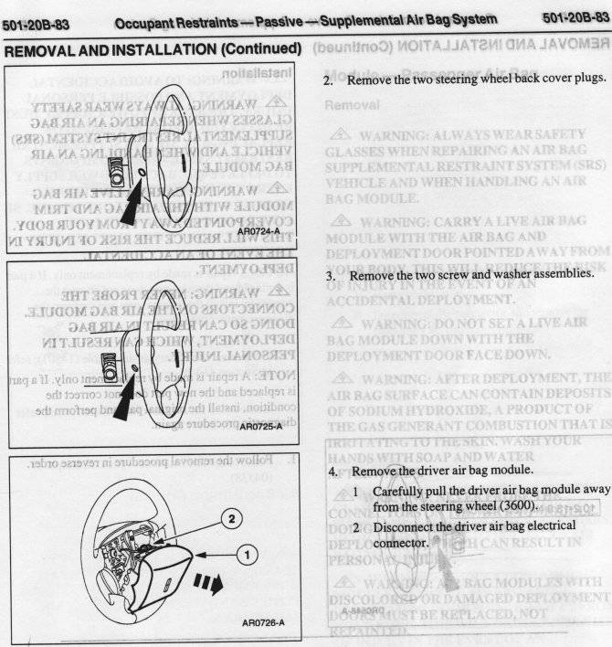

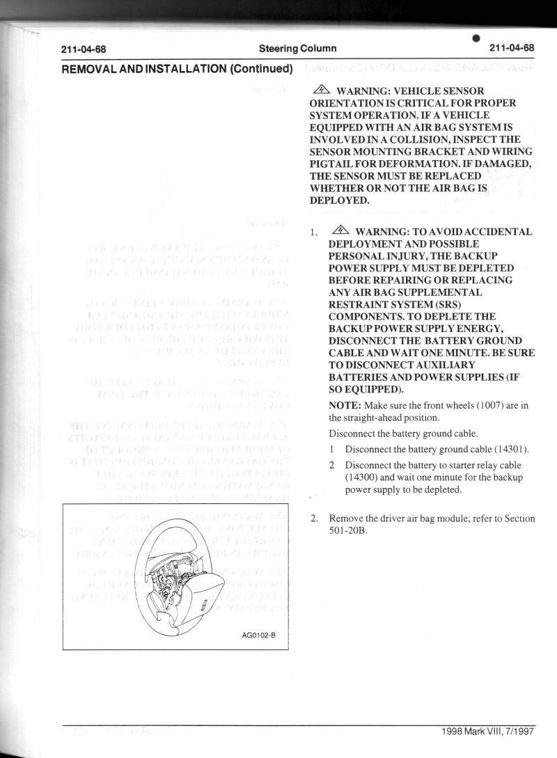

Anyone who has replaced their steering wheel, a step by step instruction would be greatly appreciated. I know I need to rent a steering wheel puller. I am more worried about anything I may run into once I remove the airbag, like the clock spring or is it beneath the steering whewel and I will not run into it?:confused:
Hope this will help
Hope this will help
Thanks to you and Shawn. I assume Shawns method does not use a steering wheel puller. I was especially concerned about the clock spring, what ever the hell that is? Sounds like it will not be as hard as replacing the shocks in the front or the air compressor.:)
