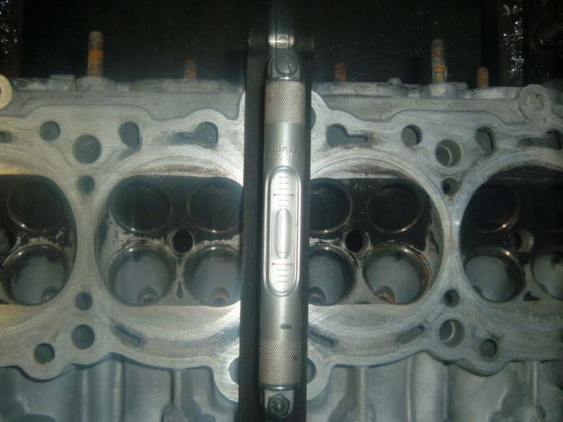

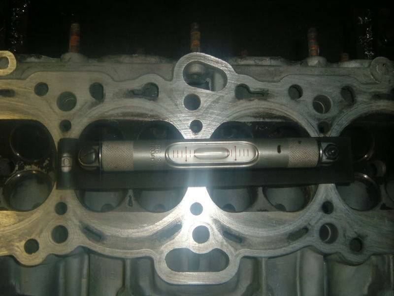

Next is to mount the head in the machine and check the level of the head in both directions.
Then the other way, this head was not out that bad from the last time it was milled.

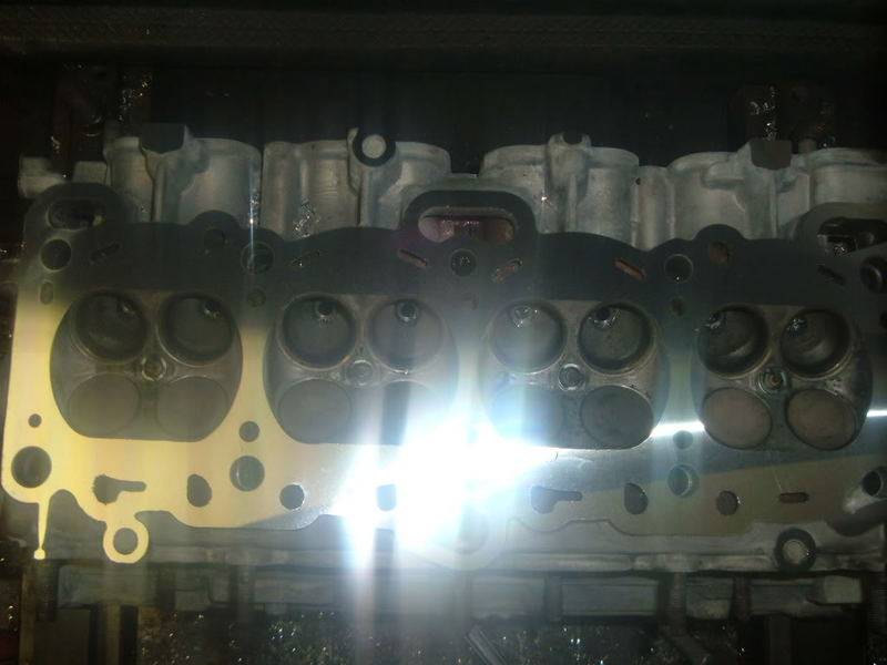

I did a “getting to know you” pass of .002 to see how square the head was. This was done on a faster setting.
Notice the upper and left side of the head is dull, this is a low spot. The head was not index properly and did not maintain a proper “square” to the valve cover surface.
I made another cut of .003, I sped up the cutter, and slowed the table speed.

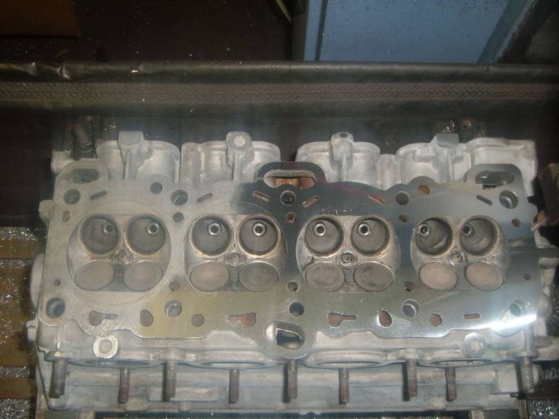

This is the end result.

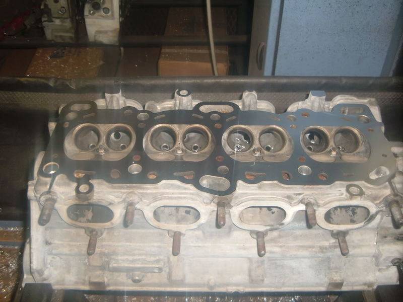

Another different view.
Now with a proper surface, and the head re-squared, The customer will have no issues with a MLS gasket sealing, and also having a closer to equal combustion chamber size.
