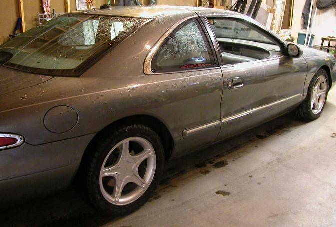

i just have 99 GT wheels on my car for now, i like the way they look except for the horse on the centercap.. but my car is grey and so are the wheels, so it looks pretty good IMO

finally took some pics today.. its started raining after i rolled the car outside, and so its wet.. thats ok, it was REALLY dusty before..
