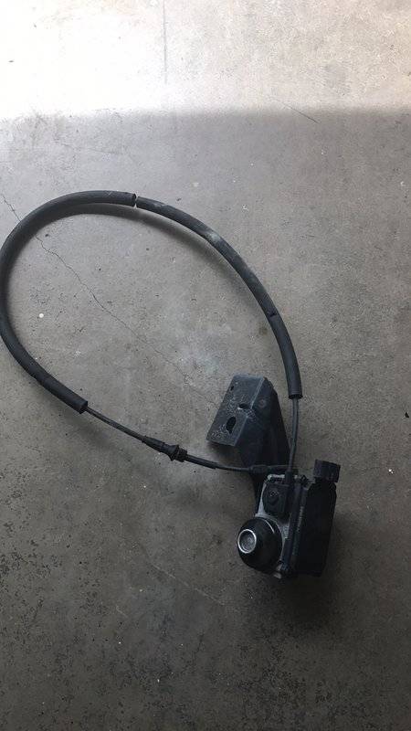

Is this what you are talking about? I pulled this from a 2000v8

Yes, that's the cruse module. Check for problems with the mechanical cable and where it attaches to the throttle. Any catches or rough spots can cause the cruise to shut off. It could also be that the servo is overheating on the module. If you can't spot any mechanical problems, then you will need to use a scan tool that can read all the modules in the car, otherwise it will just be guessing. I think the Forscan is a cheap setup that can do it.

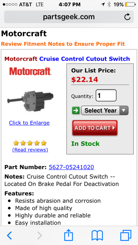

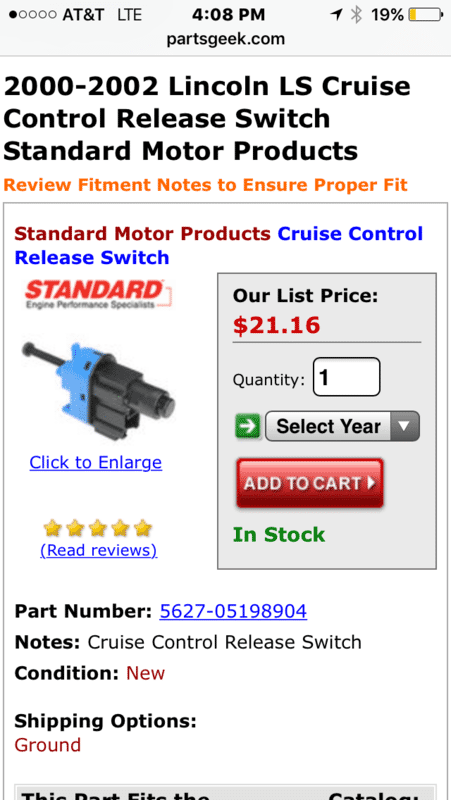

There’s two switches behind the brake... which is the “brake control switch”? Or do you mean the servo module as joegr suggested?
On the 2nd gen, the top switch is the brake light switch, and the bottom switch is the cruise safety switch. I'm not sure if it is the same for the 1st gen. It is the brake light switch that has the one-time adjustment.
Well, to be fair, either one of them will stop the cruise control if the brake pedal is not pressing on them.
1F1Z-9F924-AB is the cruise control deactivation switch (redundant to the brake light switch).
XW4Z-13480-AA is the brake light switch.
I'm not sure how that translates to their numbers, and I don't recall off hand which one is blue and which one is gray.
Edit: Brake light is gray, redundant cruise is blue.

I know for a fact I need a new module and/or Servo the damn thing pretty much crumbled and fell off my car that's Ford putting aluminum components on the LS no big deal I'm sure I'll find one online EBay is sure to have one or a salvage yard
... that's Ford putting aluminum components on the LS no big deal I'm sure I'll find one online EBay is sure to have one or a salvage yard
I'm not sure about the module construction materials, but that is actually the same module that Ford used on many/most of their non-ETC vehicles for a number of years. It's one of the rare parts on the LS that was used on other cars too. (The bracket and throttle cable may be unique to the LS, I don't know.)
