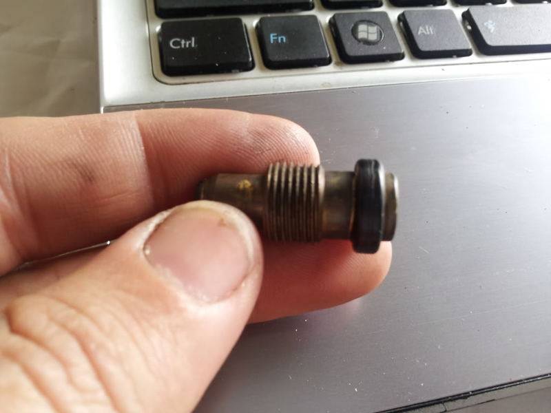

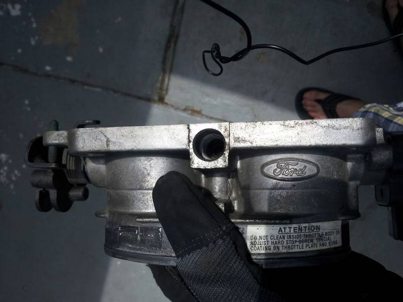

This was the vac leak on my car. Is there a procedure on how to adjust this screw. I just screwed it all the way in.
Figured out it's the idle adjust. Where should the car idle at? The car is idling around 900rpm's right now...

Ya 900 is too high " almost like you may have a vac leak " my 93 idles round 650.

Should smooth out wit new plugs and filter just tighten brass plug in snug ,that's what I did and she idles fine and no more cel light
