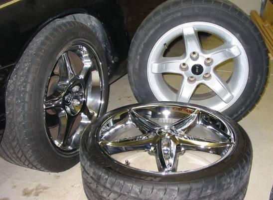

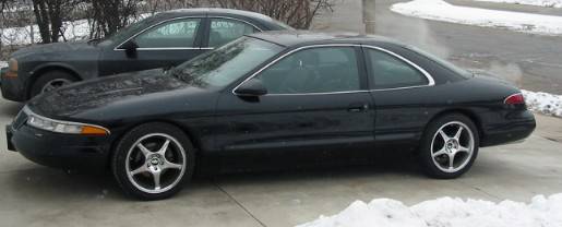

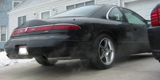

Well you can get that rim in a 5x4.25 bolt pattern, or at least you could at one time. The 17x8.5 seems wrong. They were typically made in 9.5" widths and shallower offsets. Mine are 18x9.5 with a 36mm offset, they would definately stick out if I stuck them on my LSE. That center cap is identical as mine. I got mine from the now out of business Performance Wheel Outlet. The boxes they came in said Dante Design IIRC. Summit now carries that name brand, but not in the right bolt pattern. I'm pretty sure Performance Wheel Outlet would buy the rims(slugs) unfinished and undrilled, them finish them from there, giving them a bigger fitment selection. Doesn't help you, bot thats what I know.
