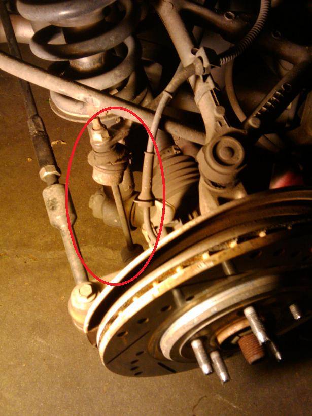

can someone please identify this part for me? i want to order the pair from Maxx tomorrow and i just want to make sure i have the right part. also, is it Vin specific? so if it is i will take my vin number to work :D. thanks in advance

yea rear sway bar link. The half shaft gives it away that it's in the rear.
sry guys, should have mentioned it was the rear. Andrizzle, is rockauto the best place to get both of them? i'm use to buying everything form Maxx. thanks
Yup that's them. You can just search your LS year on rockautos catalogand click suspension and find the parts u need. It is really simple to find what you need on there. And from my experience they have the best prices around. And they ship fast as balls.

so i'm assuming it's as easy as it looks to change out these rear sway bar links right? i only see two screws, pretty straight forward? Andrizzle, while rockauto had a better price i went with Max, just because i am doing a full tune up and i wanted to change out my valve cover gaskets. i rather pay one ship price. thanks for the link though, it might come in handy down the road. speaking of tune up, what would be some of things you guys would replace? i'm thinking of doing the hydraulic fan and power steering liquids. i will wait on the brake fluid due to me wanting to get the SS lines. what else? thanks guys

Yes, it is.
http://deneau.info/ls/s6x~us~en~file=s6x42009.htm~gen~ref.htm
You should use a torque wrench if you can.
thanks for the link. you always have those cool diagrams, did you buy the cd manual? also, in the link it says to put it in neutral and then hoist, i do not have a hoist, so do i have to jack it up or can it be on the ground?

Yea the Mood parts are about 2x as beefier. And they won't dry out and crack like the OEM do with age, they have a regreasable boot that covers the actual joints.

yes...moog in the rears is the way to go. the rubber boots are better, the steel is thicker and they are greaseable. the Deeza front links have the same boot and are greaseable like the moog's and are thicker too. i havent tried em yet but the Deeza are around 1/2 the price of the Moog front links and 'look' just as good
