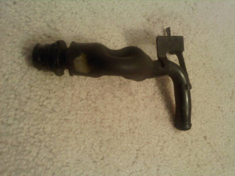

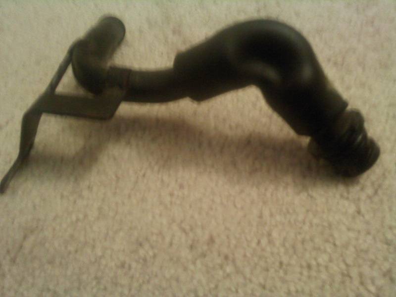

i got the lower intake off and found the PCV value. seeing it I remembered something from the past. can you believe I think I once changed this PCV valve years ago without taking off the lower intake. With the upper manifold off and all the wires pushed back I got a deepwell socket in there and twisted it out and twisted the new one back in. the socket was just the right size to fit around the square part (4 points) of the pcv valve... (maybe it was on my brother's sport trac explorer but i really think it was on this car)
maybe it was a miricale. here's a pic of the pcv valve for an idea of the square part
anyway...
my pcv valve hose elbow wasn't cracked but it had collapsed alot. I hope this is the issue. air flows freely through it until I squeeze it a little, collapsing it more.
see pics: (sorry they are burry)
what do you guys think, is this probably the problem?

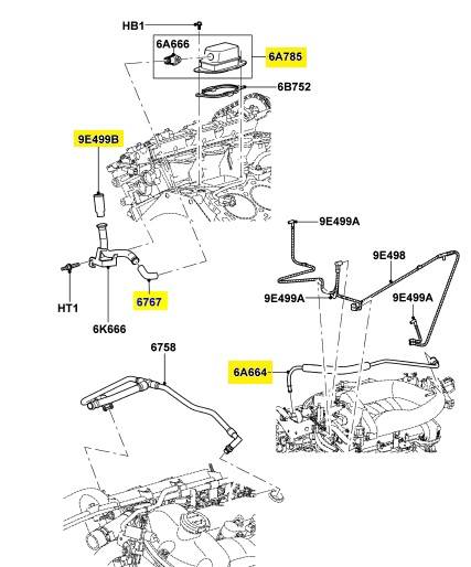

I also have a few more questions. here is a part diagrams:
(for people's FYI part # 6767 is the collapsed pcv valve hose elbow.
can part # 6A785 be taken out without removing the heads? i wanted to see down there, but can't get it out from between the lips of the intake holes in the heads..
part # 6A664 is the rest of the PCV valve hose. can this just be replaced by like a 1/2" hose? or is this something special? (is this something I am reading about an Emission Separator?)
thanks guys!!!! I am trying to ask a few questions and also provide info for others who come across this issue. NYCLS8's directions and pictures in the excel sheet was the most helpful (especially tab # 7. urg i didn't see tab # 7 until I opened it on a different computer, ish - go figure, now it make more sense!!!
I don't know about the other stuff, but that PCV hose has failed! IIRC that hose is under vacuum and when the engine is running the hose will collapse even further.
ah thanks LS4me. that is what i was hoping someone would say. I was a little upset when I didn't see any cracks or holes in it. i will replace it saturday and put it all back together...
