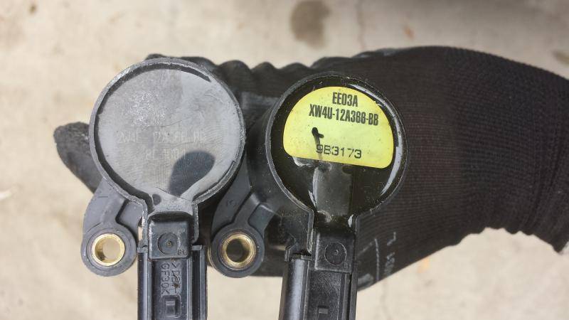

I put in e3 spark plugs monday and noticed my cop's were different
6 had a yellow sticker on top and some square shaped bump
2 didn't have the sticker or the bump
Are the ones with the yellow sticker oem
