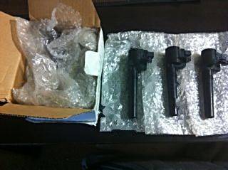

They looks like wells brand coils.
same ones sold all over ebay.
yeah 2 of my coils went bad i ordered this same set and replaced them all car runs great now espically after that gasket job i did
