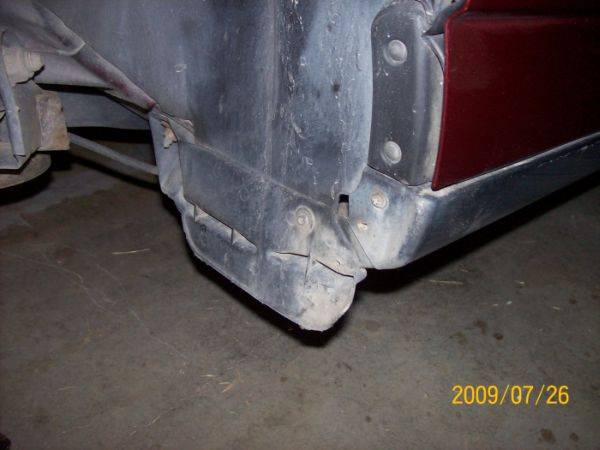

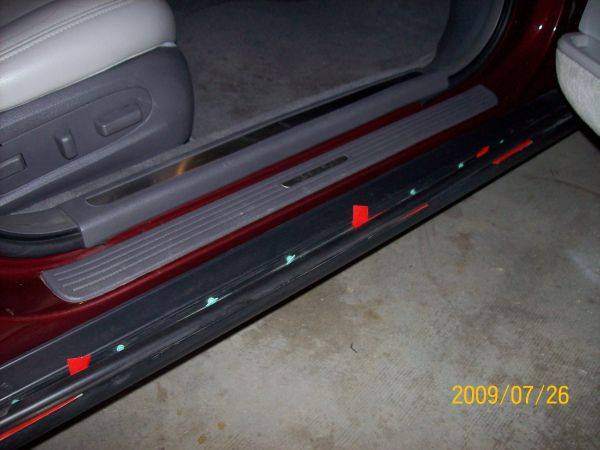

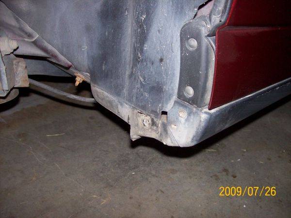

I installed the new side skirts tonight. Definitely noticed a difference in how they mount up this time.
Picture 1 & 2, I removed the splash guard from in front of the rear tires.

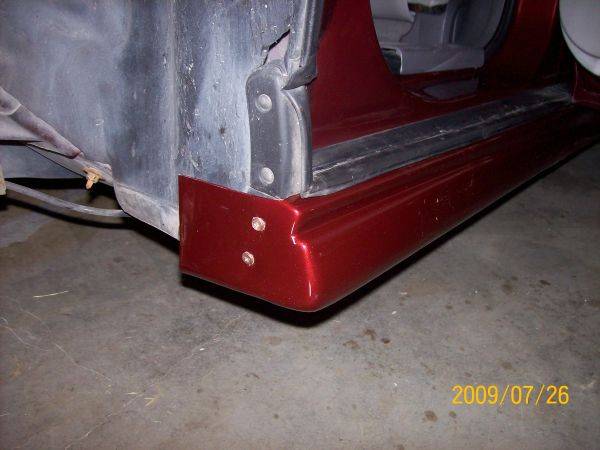

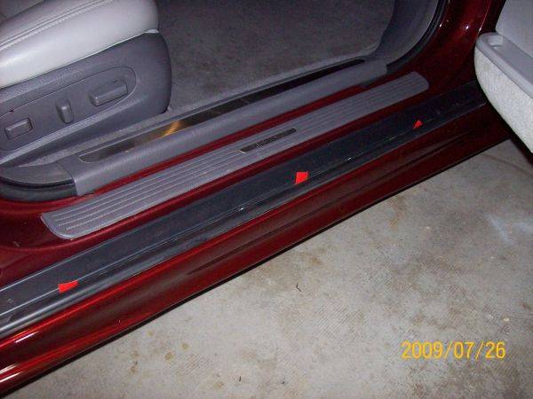

Picture 3 & 4, I put the double sided tape under the weather stripping. I dog eared the ends. Once the side skirt is in place. Just pull the tab and press down.

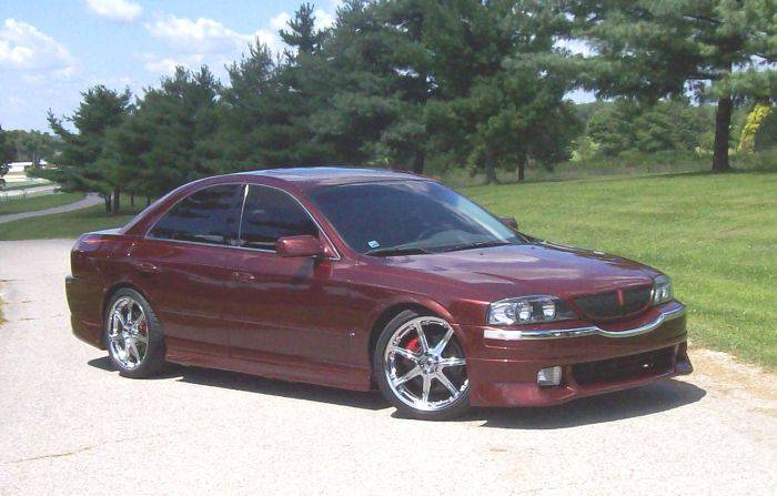

Picture 5, screw in two self tapping screws at each end. Done.

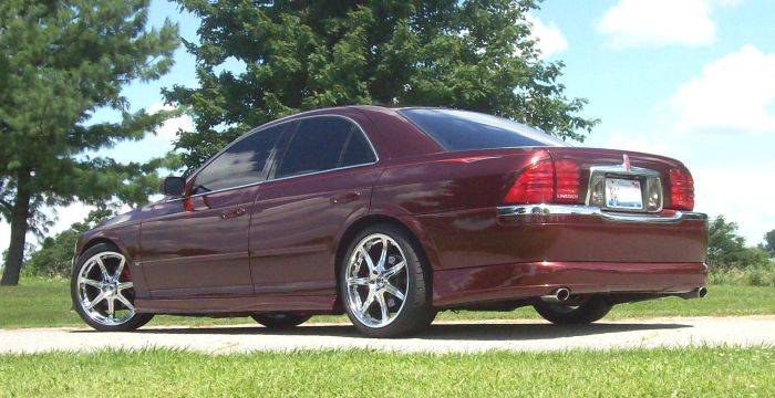

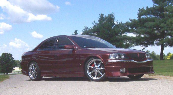

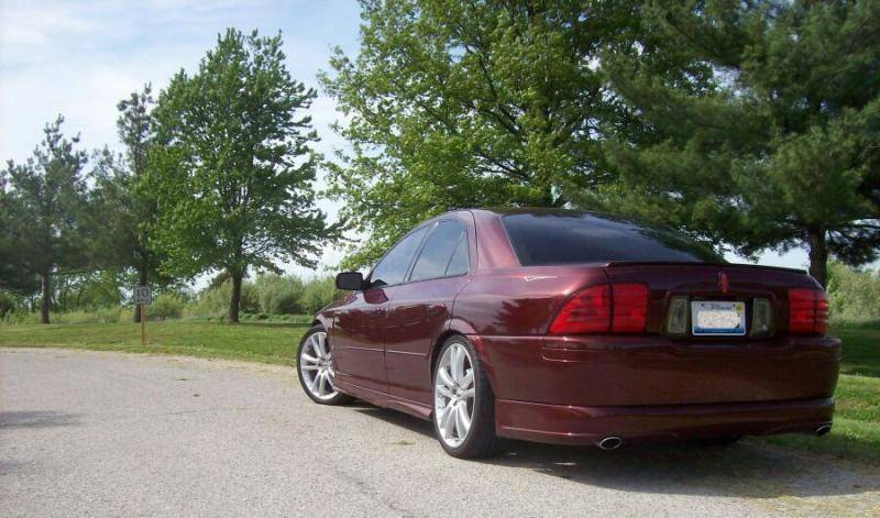

Here are the new pictures of the side skirts. The light panels to the side skirts tock under the LS a lot better. They aren't as noticeable anymore.

Looks good. But yea I still don't see the difference? Was it like that guy in the other thread said they were just cracked?
In the top picture, the two rectangular pieces are very noticable. In the bottom picture, the splash guard piece removed. The side skirts tuck under the car better. The two rectangular pieces are tucked further under the car. Less noticable.
BTW Yes. They were cracked BADLY. Razzi set me a free set to replace them.

Oh ok. That top picture just looks like your rear end is sitting lower. Must be the camera angle.
