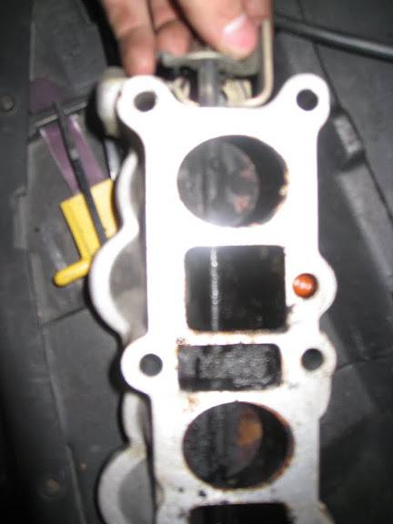

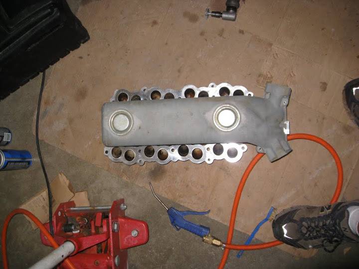

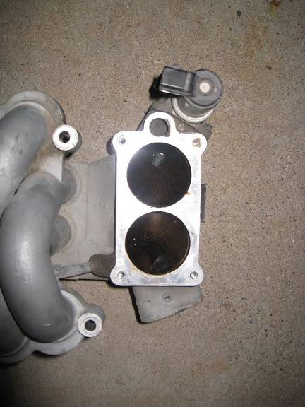

so, being tired of being slower than my brothers SHO, even with 4.10s, i removed my intake and imrc's for a little bit of cleaning. well turns out, they need a lot of cleaning. i can't believe the imrc's still moved. my egr was completely choked. wow.

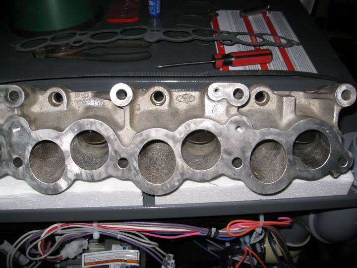

so the imrc's are all clean, now how do i clean out the intake? that thing is full of twists and turns. no way my trusty toothbrush is gonna get in there.
how do i get the gunk out?

If it is really that bad I would take it to a local shop to put thru their hot tank, then when I got it home wash it down again with hot soapy water, rinse, blow off and let dry.

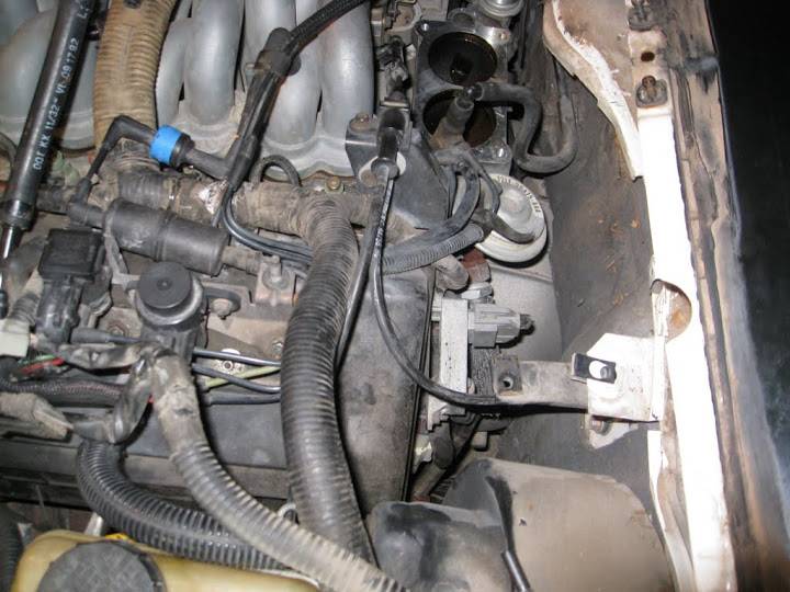

no walkthrough. just started unbolting everything i could find. hood, cowl, wipers, intake, fuel rail, egr tube, throttle body, iac, and so on. it is pretty involved, but i wouldn't call it hard.
i have had many 5.0 stang and truck intakes part. this was harder.
find a picture of an intake and you can see everything that will need to be unbolted.

that's what i'm thinking as well. hot tank it is.

When I had mine off, I soaked everything in a big tub of home-brew solvent... Pretty much straight lacquer thinner with a quart can of methylene chloride paint stripper for added dissolving action.
It worked pretty well. After several days, all the carbon build up on the IMRC's just rinsed off with a quick one-over with a scrub brush, but the intake itself was a little more work. I used a certain size flexible engine-cleaning brush that would bend up around the turns in the pipes quite a ways, but that gray coating on the exterior was a real job and a half to remove.
It turned out nice though. I even polished the tubes, and hit the whole thing with some clear. It looks GOOD...

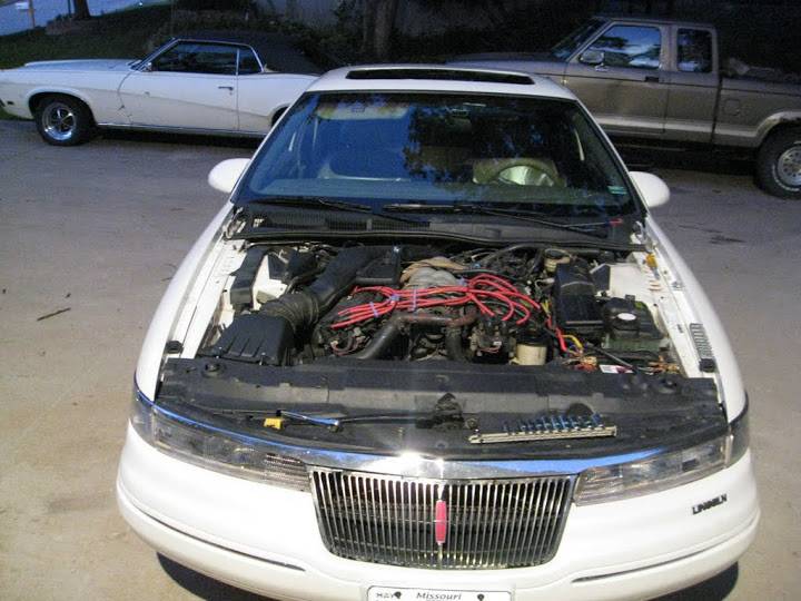

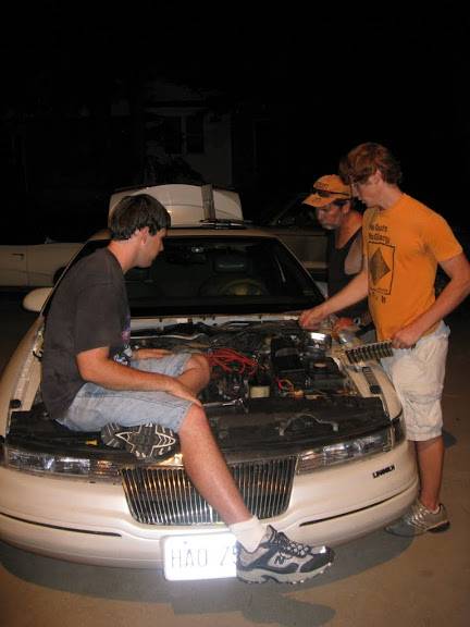

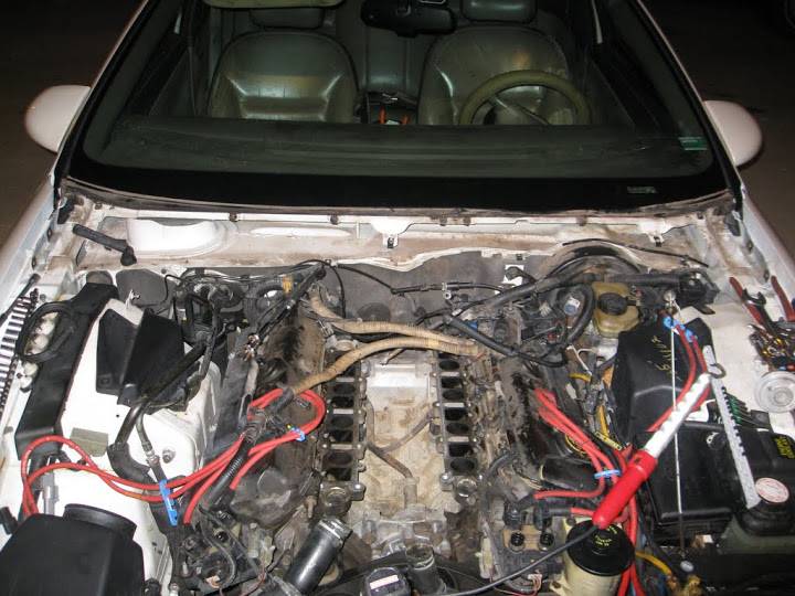

picture time. i documented my experience in pictures as best i could.
the beginning.

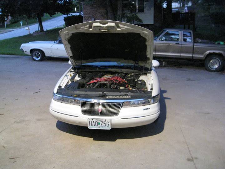

hood off.
hood in the yard.

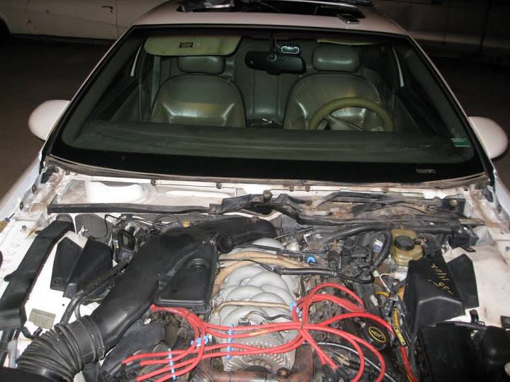

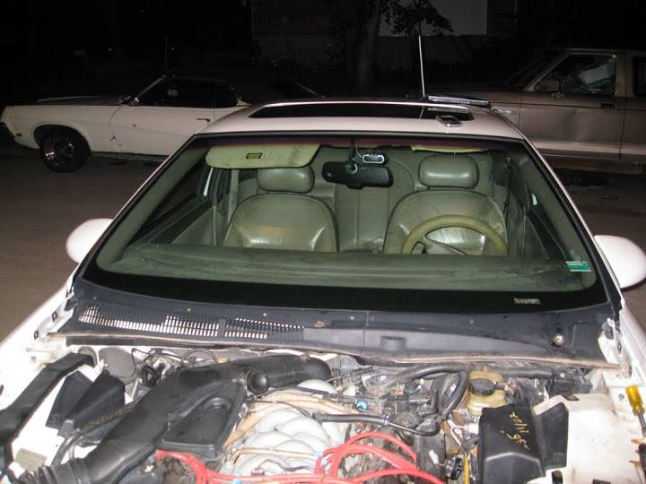

wiper cowl.
cowl removed.

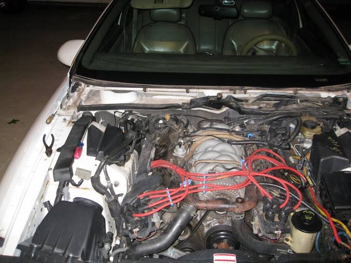

intake tube off.

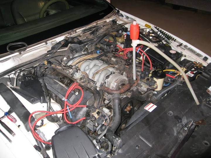

sucking out the antifreeze before pulling the crossover tube.
imrc vacuum actuator.

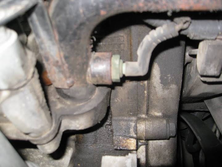

coolant temp sensor.

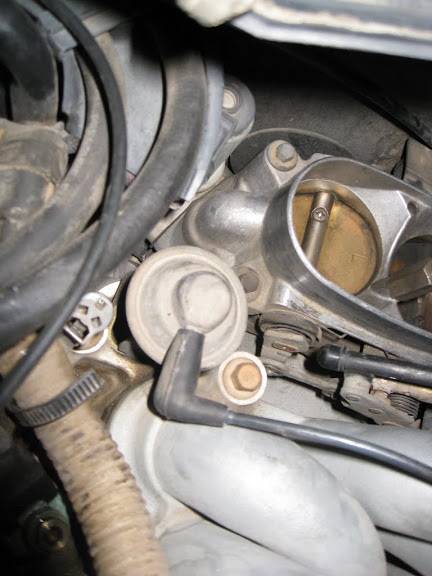

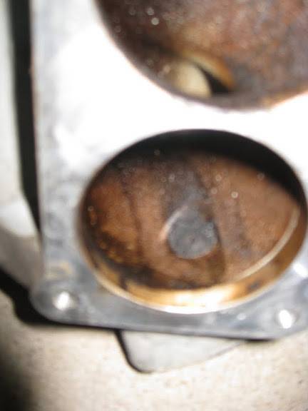

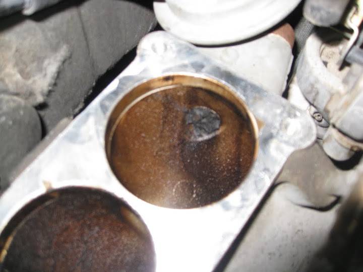

completely choked egr causing a CEL.
throttle body off. can also see egr and pfe sensor.

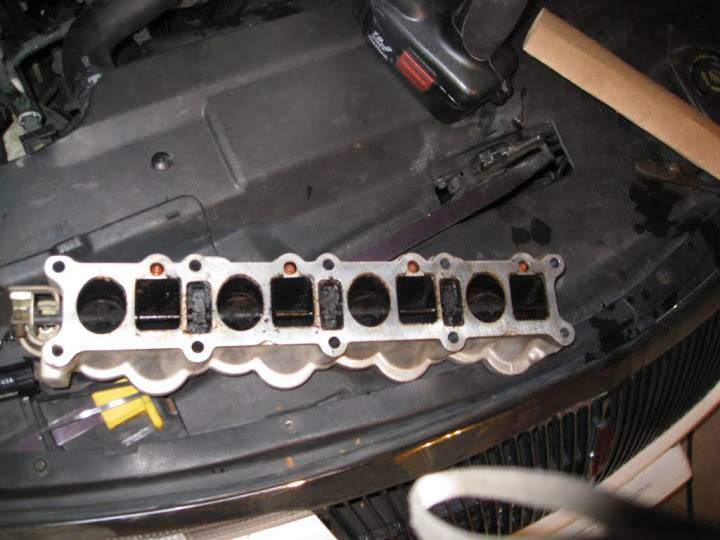

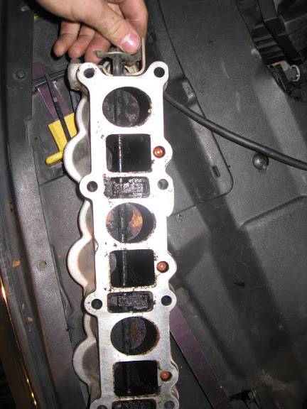

dirty imrc.
dirty imrc.
dirty imrc.

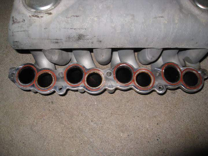

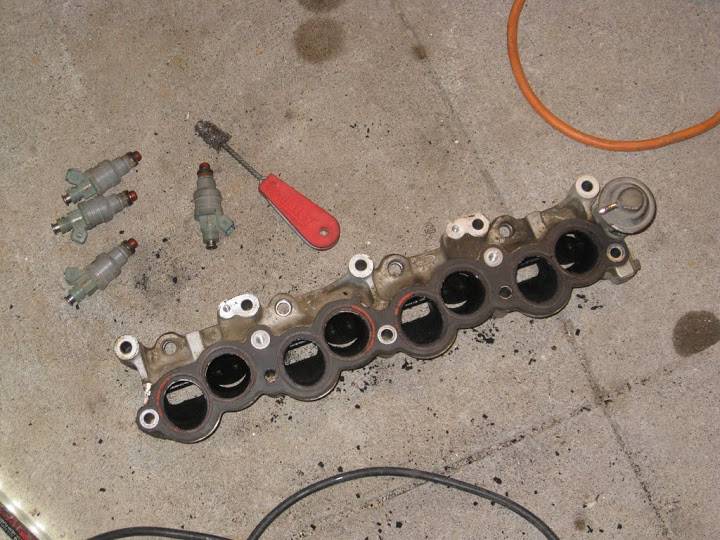

dirty intake.
dirty intake.
more choked egr.

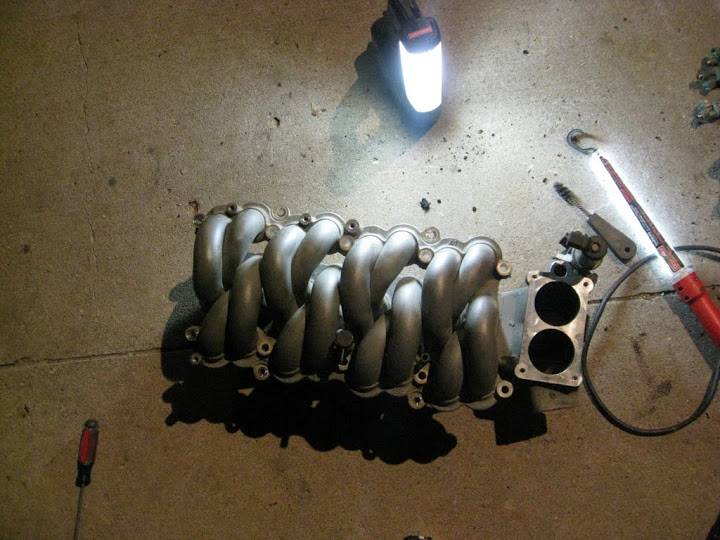

intake and shot iac.

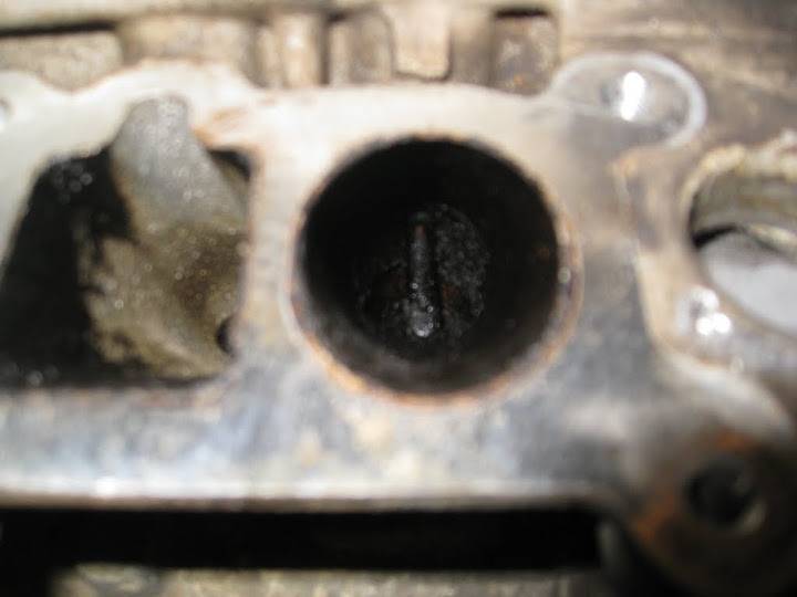

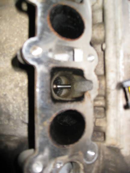

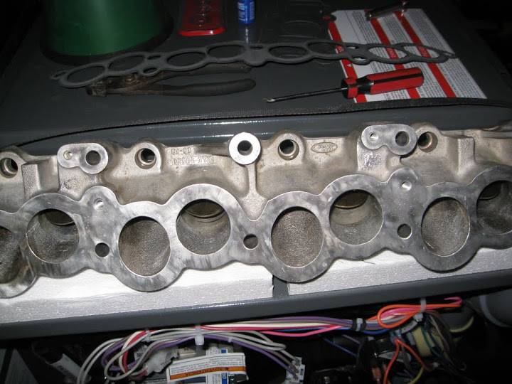

shot down the head. injector side.
shot down the head. non injector side.
everything removed.
dirty intake.

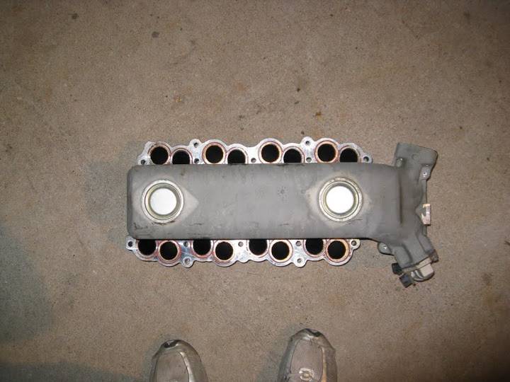

dirty imrc.
clean IMRC! new orings at the ends of the shafts as well.
clean IMRC!
clean IMRC!
clean intake!
Never thought about this but, this is a good way to get to the egr and everything else that you can either replace or clean.
