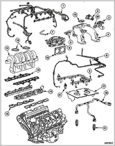

Look in the attached gif for the IMRC(#12) - the controller is at the rear.
Driller does it stick out where one can just easily replace it,or do I have to pull the intake to get to it?
You'll probably need to pull some items just to get to them - perhaps a Gen2 junky can help. Bryan(MonsterMark)?
