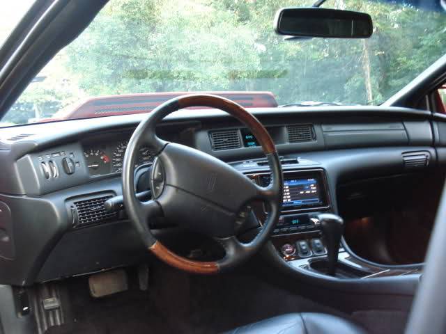

I was wondering what models the half wood half leather wheel came from. I am wanting to get one for the chamelion I believe the interior is fawn.It is almost white almost tan almost vanilla. Any help would be appreciated.
Your interior looks to be ivory. (code ZQ for base model)
Woodgrain wheels only came on the 98 Collectors Editions.
It will need to be modified to fit. Gen 2 wheels are not a direct swap to a gen 1.
I actually had to get mine cut out, and a gen 1 center welded in mine, then of course get it re-wrapped in leather to match the interior color.
You can also send your stock wheel out and have wood added. check out these places:
