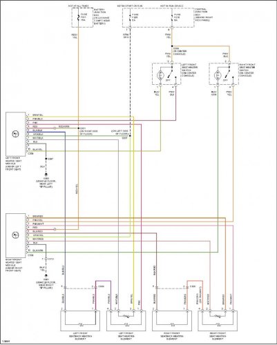

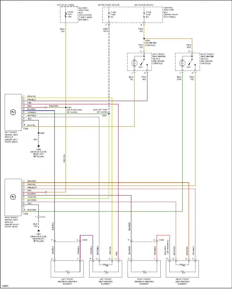

The heated seats went in without a hitch. The only thing that had to be changed was the wiring harness at the shifter and that pretty much was plug and play operation. But I do have one small problem. The drivers side seat warmer does not engage; the light at the switch does not turn on. Is there any wiring differences? Both switches work with the backlight illumination however.
EDIT: I did notice that the drivers seat had a small black connector with a few wires hanging out of it. Could that be the reason why? If so, where does it plug into?
