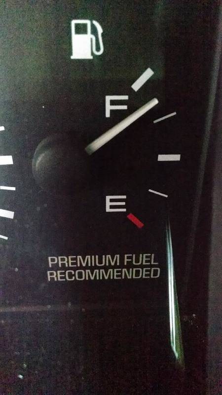

Spend the extra for premium, it all equals out in the end and your mark will be happier. Been there done that more than I care to admit.

I had a 97 lsc that seemed faster than all my other MK VIII's. Only mod was Mustang mufflers (sounded good). I use only 93 in my cars, it's worth the few cents difference.

Some are just faster than others. My base 97 Mark VIII with 179k beats my 98 LSC with 80k. Just change out your air filter, fuel filter, and spark plugs (Maybe coils also). Start putting in premium and see if your IMCRs open when you go past 3000 rpm. Other then that, it's up to mods to make your car faster.
