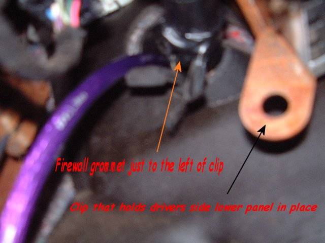

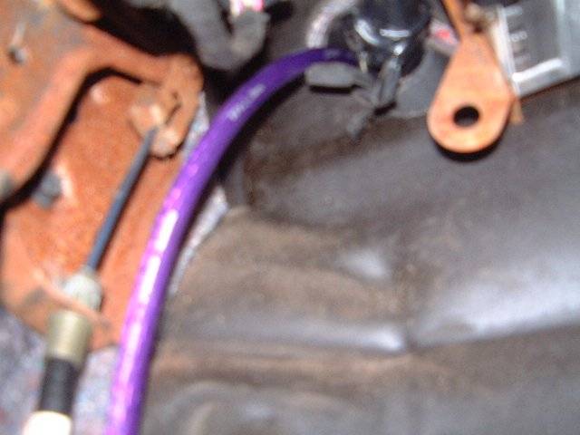

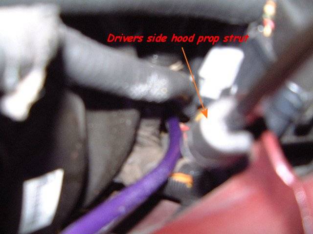

I ran 4 gauge wire thru this spot. It is difficult to get to, but it can be done. It is behind the connector on the firewall just to the right of the brake booster (if you are lookin at the booster that is), and just below it, you have to unbolt the connector to get to the spot. I have a few pix of it not only under the hood, but also inside the car. They are a bit fuzzy, but you will get the jist. Hope this helps....
Not really, it was relatively easy. I poked it thru from the inside of the car into the engine bay. I taped the wire to a screwdriver and pushed it thru the factory grommet and then pulled the tape off and pulled the screwdriver back thru the opening after I pulled the wire. Once you undo the connector it is easy to get your hands down there....well not easy, but easier.
