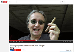

The ol' Scotty Kilmer the car guy Cigar find a vacuum leak trick.
https://www.youtube.com/watch?v=zMok2y05jNE
