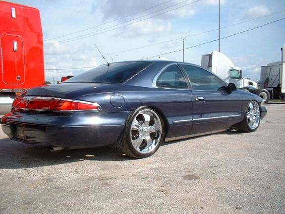

That first one is a photoshop, I know because I did it when I was in the market...Your front end will not go that far down with the stock struts up front.

Heres a pic of how low it will go with stock struts aired completely out.
