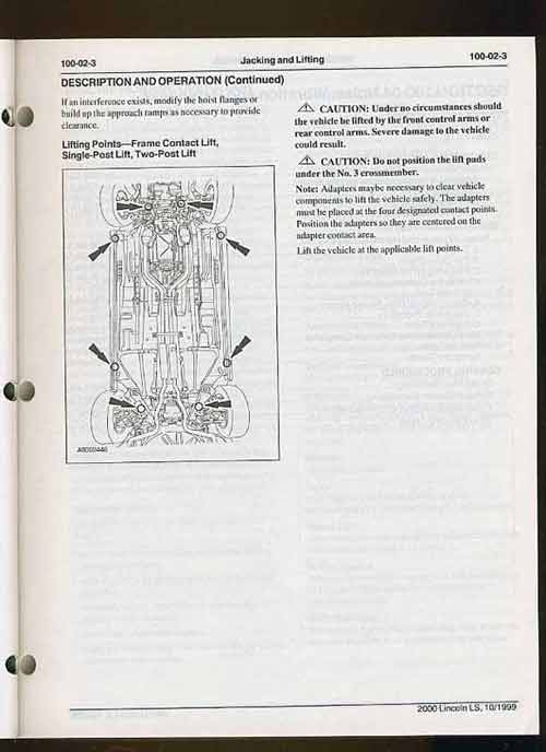

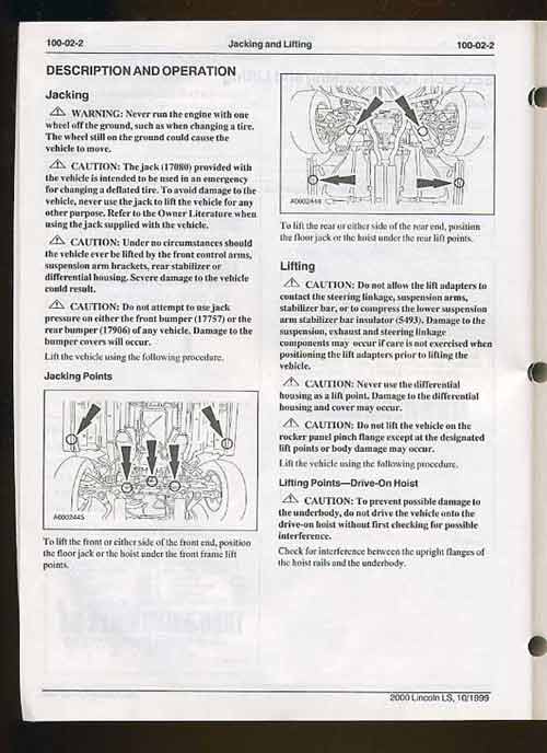

See below...
By the looks of it, that'd be the official Lincoln LS Service Manual from Helm.
It's also on the Service/Repair CD... which I have but is more difficult to take images from... although I probably could've pdf'd it...
