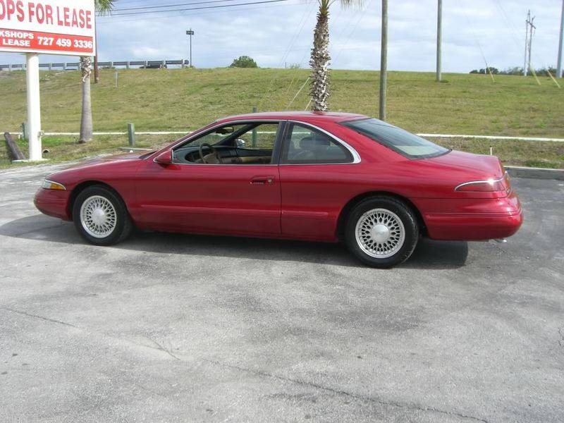

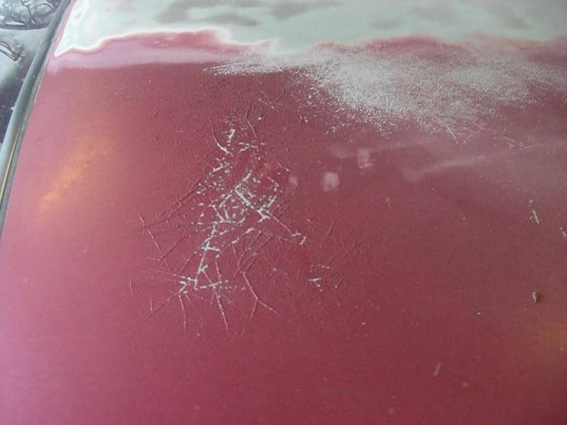

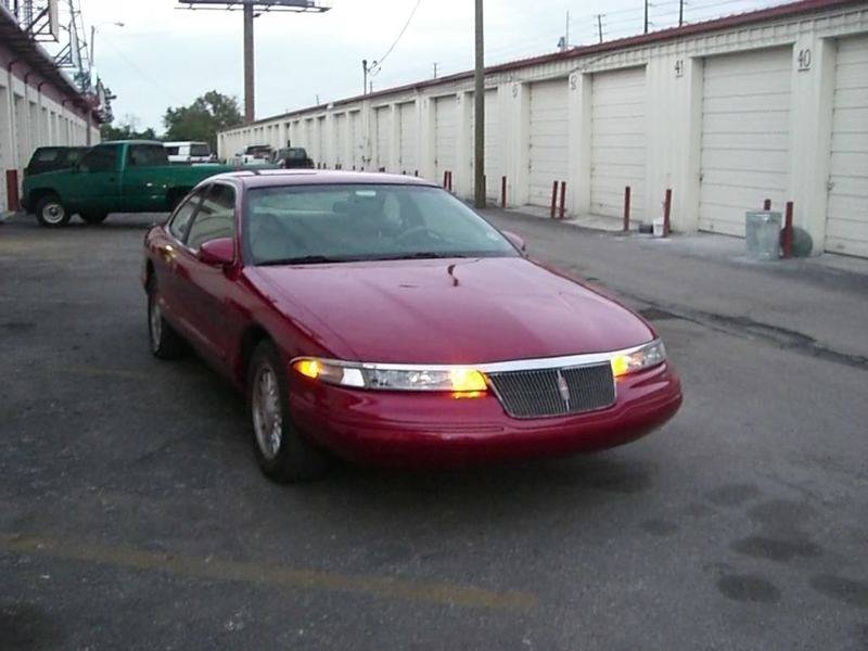

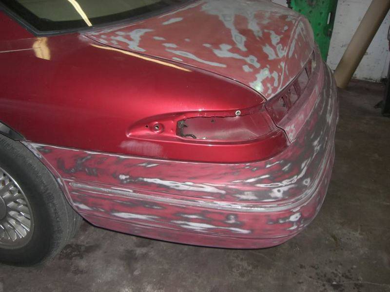

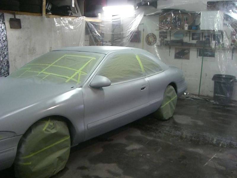

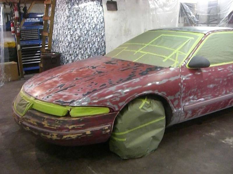

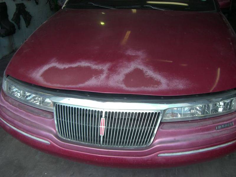

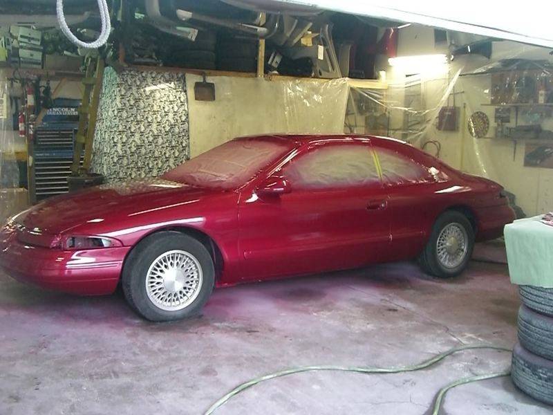

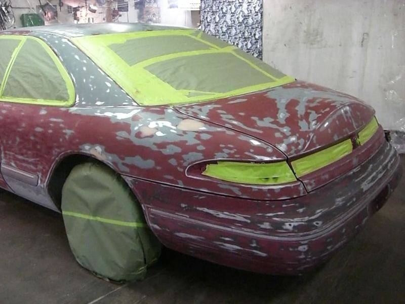

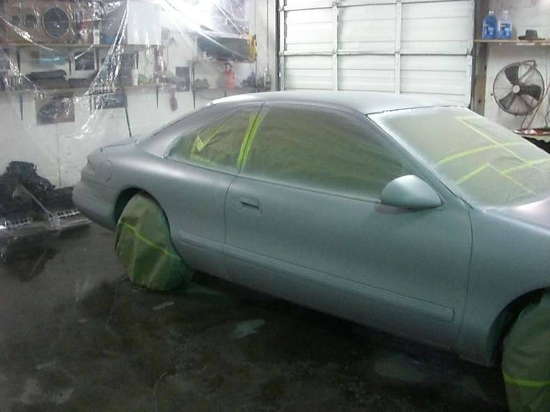

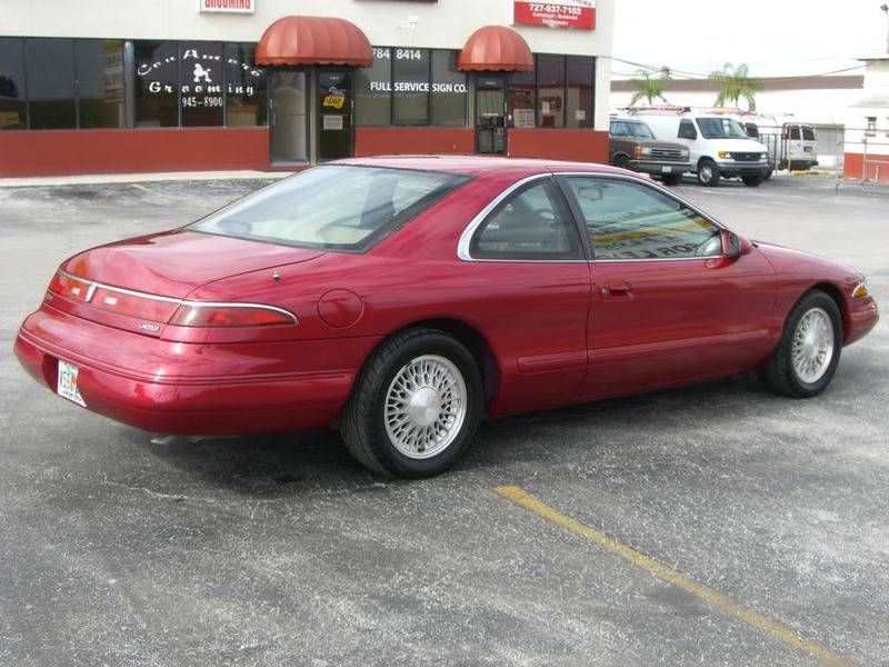

i just finished a project i promised my buddy for his wife's 94 garnett red mark VIII. i have been picking at it for the past 2 weeks, but as of yesterday morning, i started prepping it finally for primer, i got to my shop around 10 am and worked until around 7, i came home for dinner and went back to the shop, i had no intention on painting the car last night, just prime it, but one thing led to another and i opened my shop doors at 9 am this morning to see daylight, i could barely stand up anymore, i felt like i had been in a gang fight. every inch of me was in pain, it felt like heaven to open the doors and smell fresh morning florida air! needless to say i went home at 9 am and slept till 1 today, i got back up and went back for another 6 hours to unmask and re-assemble the car. tomorroe i have to swap on another set of clean snowflakes with some brand new cooper 245-50-16's and clean up the wheel well over spray and give it an oil change and she gets her car back for christmas with some shiny new garnett red glaze paint! check out my project, it was a blast lol, NOT. i dont know why the pics came out so out of focus, but you get the idea!

I personally like the paint over the chrome strips. The car looks great!!!
the biggest reason why is because the owner asked me too, second is because they werent chrome anymore, they were shot and looked horrible, so no better time to do something about them!!!
Looks great what a long day.
You made your buddy and his wife happy on christmas.

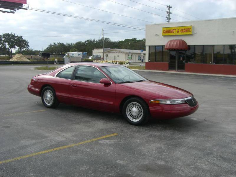

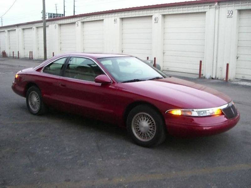

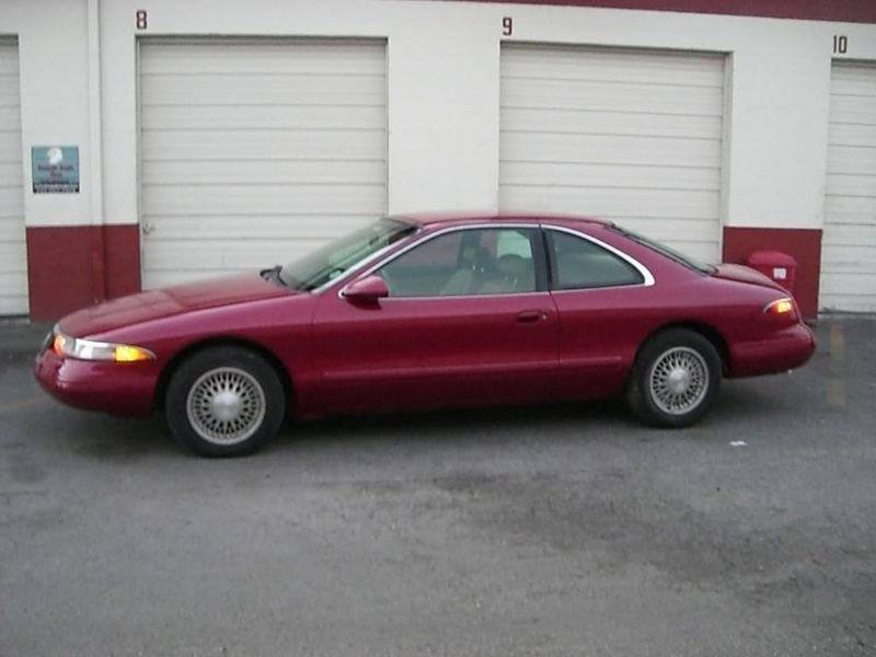

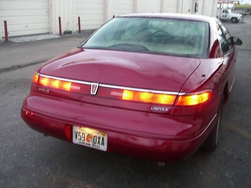

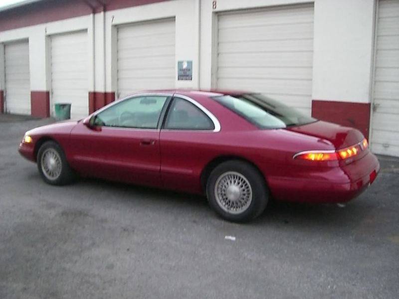

finished it up today for the owners to come get it, yes even on christmas day im in the shop. i put the keyless pad back in the door, put the door panel back on, swapped over new tires on it, and dressed up the tires and cleaned the wheel well overspray out. car looks great, they are coming to get it in a little bit im excited to see her face when she sees it. i wish i had a huge bow to put on it lol. here are nice clear pics i took today. one down, another one to go!

Any color sanding/polishing or are you just that good at spraying the paint? The car looks beautiful!
i will get the car back in about a month so i can wet sand and buff it. it does look good, but there is some orange peel, unless its factory, you'll never paint car without some orange peel. it will look like glass when im finished, but i'm letting it get nice and hard first.

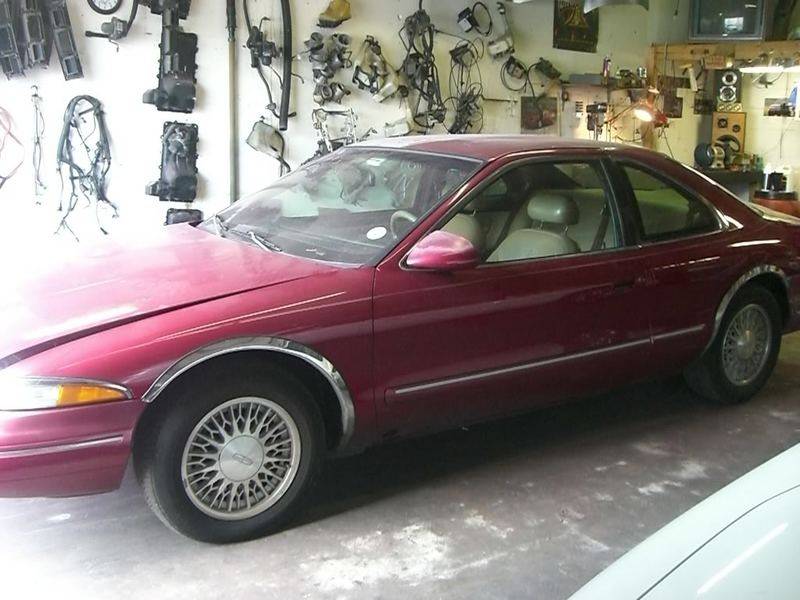

how did you set up you booth in your shop, what did you use for ventalation, I might be doing it in my gerage here in a few weeks?
i just staple up 3 mil plastic sheeting to cover everything in there, then i have a fan way up at the ceiling in the back of the shop that pulls fresh air in from the back of the building through a 6 inch gap between the back wall and roof, and i have two 20 inch box fans under the garage door plus one of them industrial orange fans from home depot that sucks everything near it up!!! i get almost no fumes lingering in my shop when i paint, they go right out the door almost instantly. a few guys in my complex paint cars, no one has a real booth, but my buddy matt pulls off some amazing paint jobs in the same type of set up as me. i also soak my floor with water before i spray anything, keeps dust down. i also put a steel chain on the cars chassis and lay it on the floor under the car. some old school guys say this is an extra ground keeps dust and crap off the car, like a de-magnetizer.
