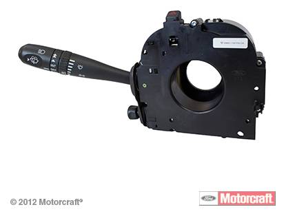

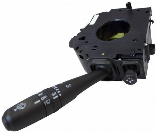

So the old turn signal switch in my 2006 is bad and I ordered a new one. I ordered a Motorcraft SW6013 which is the turn signal switch without automatic wipers.
Now on the old one the wiper control was just one big plastic knob at the end. Push it in for a wipe or hold for wipe and clean. Rotate up for intermittent or all the way up for slow and fast constant wipers.
The new one is completely different layout. Push button at end of arm for wipe and clean. One rotary dial that lets you either gets 1 wipe, intermittent, or the two constant speeds. Then a second rotary dial to set the intermittent interval.
I'm assuming it's just an updated configuration since the old style probably had a high failure rate. I do know that the intermittent wipers never worked right on mine unless you went 2-3 clicks up and that's not something limited to just the LS.
Front: http://images.oreillyauto.com/parts/img/large/mot/2w4z13k359ca-fro.jpg
Side: http://images.oreillyauto.com/parts/img/large/mot/2w4z13k359ca-ang.jpg

I show 2W4Z-13K359-CA as being for the 2002 Thunderbird and 4W4Z-13K359-BA as the correct part for the 04-06 LS. The Thunderbird part will probably work.
I've never had any problems with the wiper control on either of my LSes. (The turn signal part of it is getting a little flaky on my 04.)
Well, based on that, looks like I have the wrong one.
I have the SW-6013 which crosses to OEM 2W4313K359CA and 2W4Z13K359CA.
SW-6204 crosses to OEM 3W4Z13K359BA and 4W4Z13K359BA. It's also a replacement for SW6011 which I assume was the original turn signal switch before updates/improvements/etc.
The other ridiculous thing is that when I look on fordparts.com and put in my VIN I get both Motorcraft part numbers when searching for "turn signal switch". Maybe they are interchangeable. I guess I am just going to have to pop the cover enough to look down in there and see what the old one looks like.

My 02's switch with rain sensing looks like the O'Reilly's pictures. A button/cap for wiper mode and a separate rotating switch for intermittence speed. As far as I know, the speeds are consistent on my LS.
