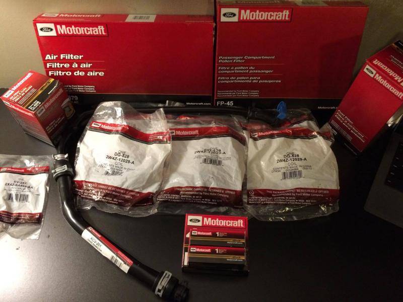

Just picked me up some Motorcraft parts for my tune up !
MysticMac
Aug 18, 2015
410
42
Vancouver British Columbia
I finally received my motorcraft parts. 6 Coils,6 plugs,PCV,Crankcase vent hose,fuel filter,oil filter,cabin air filter,air filter. Just need to pick up my Fel pro valve cover gasket set then im good to go. Is there any other gaskets i might need? thanks guys ! 13036366_10156807704900402_1512120442_o.jpg
You already replaced the IMT O-rings in the rear of the engine,right? Maybe new ones come with the valve cover gaskets,but I doubt it. don-ohio (:^)
Intake Manifold Tuning Valves I believe they are called. At the rear on both sides of the intake manifold,they are notorious leakers. I have already done mine,but I have more leaks to address if I ever get over this flu.LOL! don-ohio (:^)
IMT -O rings?
yeah i know the ones your talkinga bout now.. i have a small tiny leak coming from that part of the engine and dropping oil on my exhaust manifold
Wish I was able to go out and start on the 04LS V6 valve covers,intake,and COPs, but I'm stuck for another week or so.
Hope your repairs go as smooth as clockwork. don-ohio (:^)
Did you get new upper intake manifold mount gaskets? Look like oval O-rings under the intake manifold. don-ohio (:^)
no i did not.. i have a txt file on my old computer that has a list of all the gaskets needed. wanna do me a huge favor and reply with a list of gaskets needed for the coils and plugs and any other gasket you suggest i should change while doin it all? haha
I haven't done it all yet. I just knew THOSE have to be replaced.When I do it,I'll probably be short a coupla gaskets meself! LOL! don-oio (:^)
