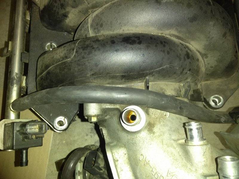

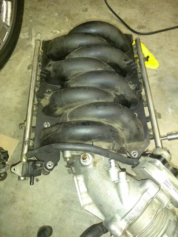

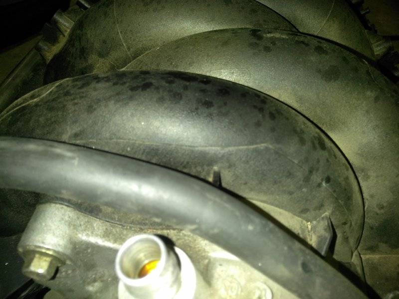

Thank for all the welcomes. First question. I can't seem to find any info on this. In regards to the intake manifold. Are these prone to cracking like the 4.6 or does the mold make it seem that way? I am attaching a couple of pics of what I am talking about.
Greetings Thorn,
That's just the way the intake is made. Has to be some sort of molding inlay. Sure I've seen that before.
GLWR's
with molding I believe it's called a parting line. you could trim off the flash and there might be a couple people here that have painted theirs
No, they don't crack (unless bolted in with the wrong torque and/or sequence). There have been some cases of the seals between the plastic part and the metal parts hardening and failing. Those are hard to find and expensive, but available. (RTV has been used too)

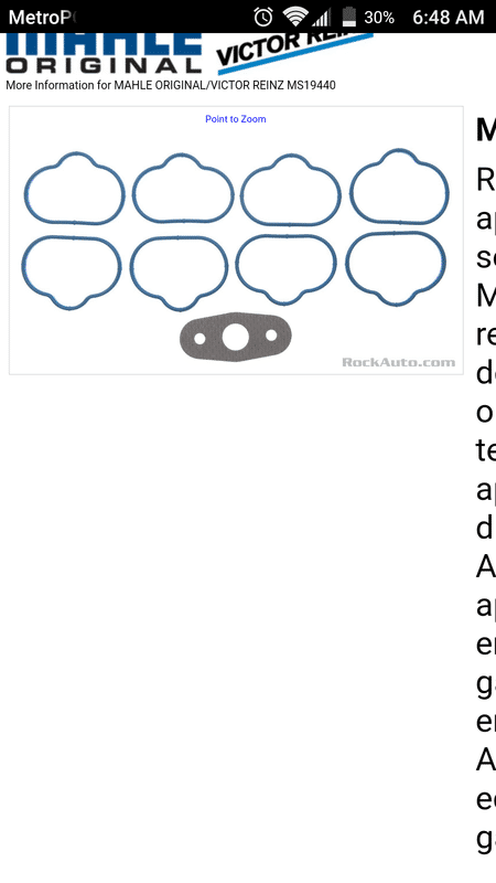

Those are the gaskets. I wouldn't really call them upper intake gaskets since the V8 really only has the one intake, unlike the V6.
Excellent just wanted to be sure. Btw Price wise I got them for $8 and change...Compared to the vct seals which I think were $12 EACH!
