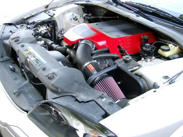

Either of the K&N units will perform well but the non metal one will heat soak less providing the best overall performance.
Hey guys, Im new here...I have a 2003 V8 LS, and am having the same dilema. I dont know which K&N to purchase. I like the aluminum tube on the Typhoon but it does state the FIPK provides a little more HP. I have also noticed the FIPK was iinstalled in mostly trucks and the Typhoon in mostly cars. If anyone has experience with the 2 and can provide some advice, I would greatly appreciate it!!
Is there a K&N filter with heatshield for a gen 1 V8? i didn't see anything other than the drop in, which i already have...
The dyno on a 03 T-Bird 3.9L V8 shows a 15.69 hp @ 6000 gain at the rear wheels, should be exactly the same gain for 03+ LS.

Ill let you know once I install mine!! But I think what everyone was talking about was the KKM intake. The KKM intake doesn't have a heat shield so on hot days or while sitting at a red light the intake will suck up that hot air. The K&N's DO have a heat shield which I would think either eliminates or atleast reduces the hot air intake into the engine.
