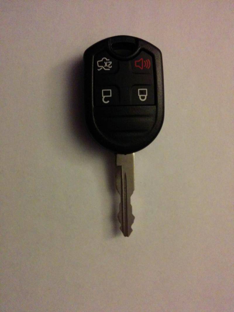

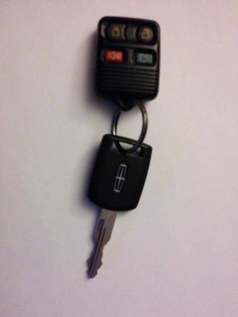

Bought my '06 last week and got the itch to do SOMETHING given the season and weather. When I had my 2007 Mustang, I came to really dislike this (mostly because I kept breaking off the tab that kept it on my key ring):
So I replaced it with this (just like I did with my Mustang):
Its a Fusion/Zephyr/MKZ key. and all four buttons work. And my LS starts (wiping sweat from brow). You can program the memory settings as well.
Just a few notes:
  • Before you get the key cut or programmed, make sure it slides into the ignition
  • Program the buttons next ... you don't want to pay for it if the buttons don't work
  • Have the key cut and make sure it starts the car ... this can be the tricky part.
Works perfectly for me (ymmv). Had mine done at the dealer when I was having the car checked for a few other little things.
Happy I did it and would recommend you doing it if you want a "cleaner" key + remote.
