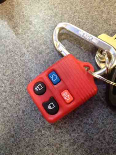

My keyless entry remote decided to randomly quit working. I replaced the battery with two new ones, and nothing. So I bought new ones online.
However, for the LS it says the dealer has to program it.
Anyone ever done this? Can I get a how to? :)

Yeah of course I have an 02. Complete BS... Same remote.. Easily programmable on any vehicle besides the 00-02 LS.
Dealer does it through a scan tool I'm guessing? Dealer wanted 59$ for a keyless entry remote. Another 60 to program it. Ridiculous.
12.99 for two on eBay.
Hopefully someone near the Detroit area has a suitable scan tool. Mine is a MAC. But doesn't have the feature. Thanks for everyone's help. Anyone have a tool in the thumb that can do this? I can drive/throw some money.

50$ later... And I now have 2 programmed remotes.
12.99 on eBay for the remotes
50$ for program at the dealer.
