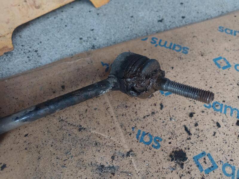

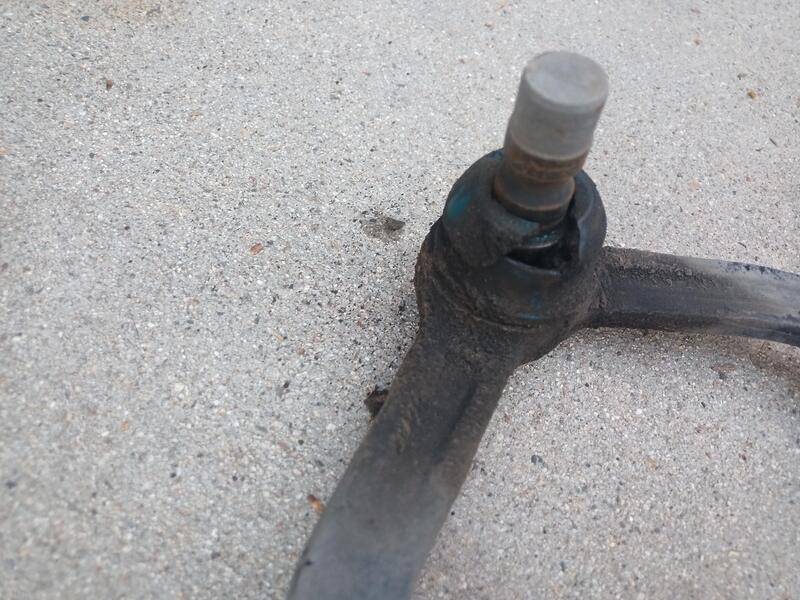

I got it home and did an inspection of the front end, it looked a mess...
I was wrong, it was a huge mess...

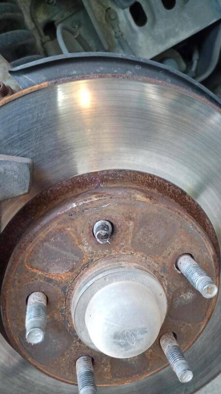

Finally got the wheel off, more mess....
Hands were too greasy to keep taking damage pictures.

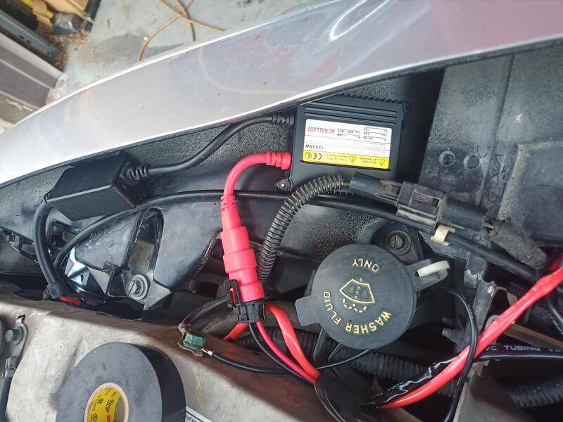

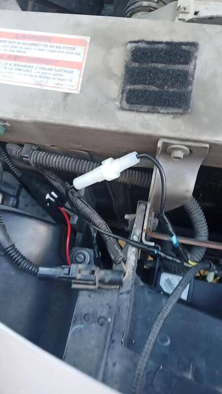

Headlights don't work, started looking around, butt connectors for days... All messed up, not sure what the heck the previous owner was doing, they glued in these bulbs...
I built some brackets/pieces to fit new lights and got new HIDs installed, they work great!
I'll try to get pictures of the setup, it's a bit ghetto, used some fiberglass bonded sheet metal material I got from work.

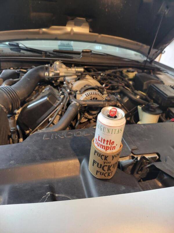

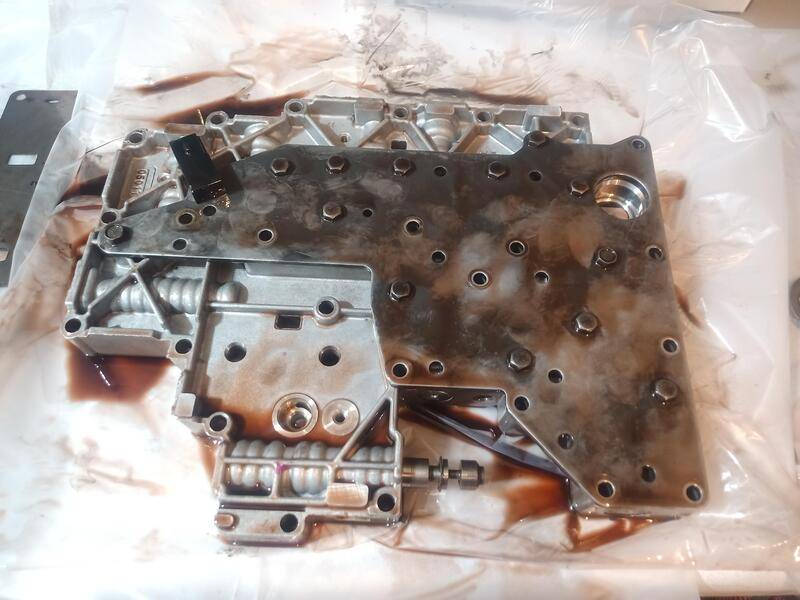

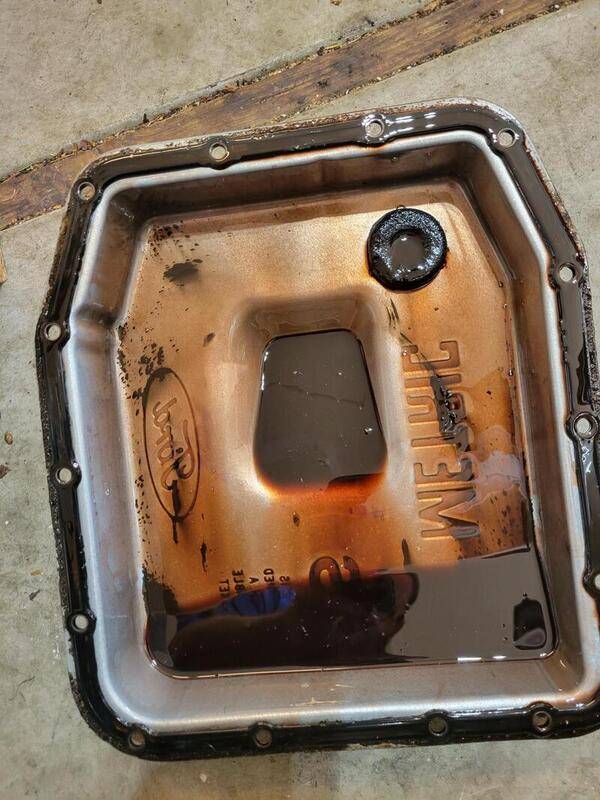

Transmission wasn't shifting right, bought everything for the J-Mod and rebuilt the valve body. Not great pictures this time because I was covered in trans fluid most of the time... Shifts way better! Apologize if anyone is offended by my garage koozie.

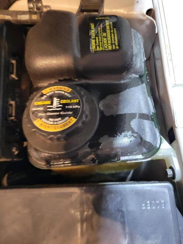

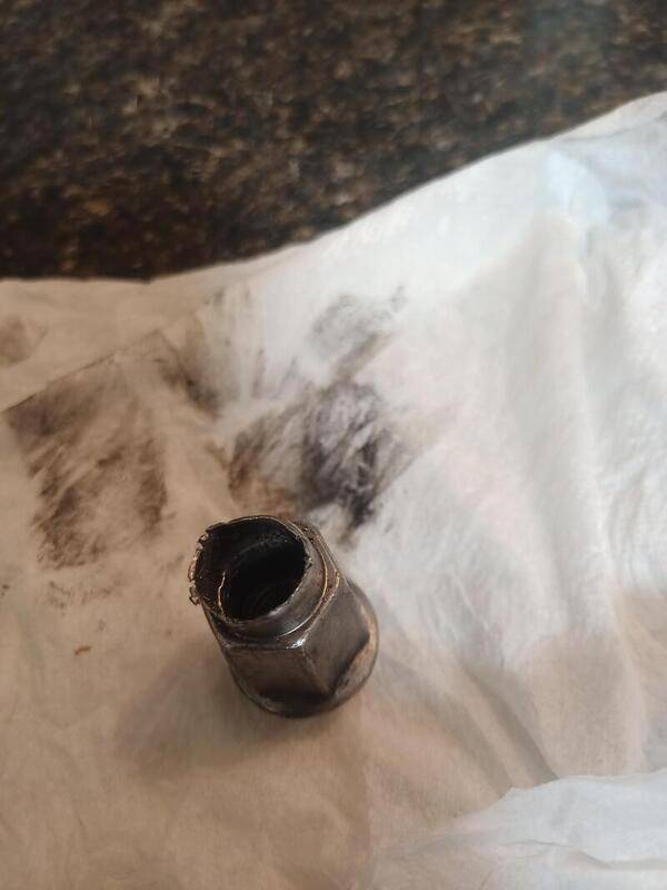

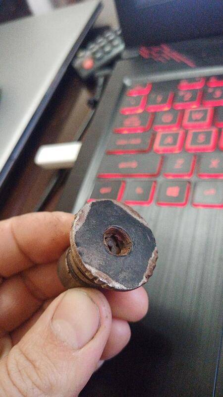

Now I have coolant bubbling out of the reservoir cap after it warms up and the usual destroyed bleeder screw, purchased a new one to replace the vice grip special. Hoping this isn't anything serious. Going to do a proper flush and replace the thermostat to see what happens.

As for the coolant cap, they are cheap enough to replace as well when you flush the coolant system and R&R the thermostat.
Thanks driller,
replaced the cap already and it still boiled over, not over heating, hoses aren't tight like I have seen with head gasket in the past. Doing the thermostat and water pump while I am doing a flush.

New overflow cap, thermostat, and water pump along with a few flushes and proper bleed of the system fixed the issue with the bubbling over. The heater in this car is insane.... super hot air.

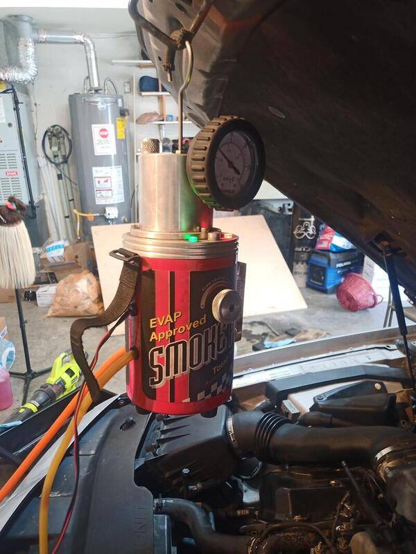

Next to tackle today is a vacuum leak, going to pull out my smoke tester and have a good look.

When you own as many old hoopties as I do, this pays for itself very quickly.... None of that carb/ether spraying around the motor.

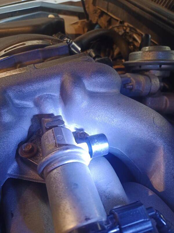

I am seeing a very slight leak around the IAC, is this little valve supposed to leak just a little? If not I guess I should replace it.
Otherwise I am leak free!
Glad to hear things are sorting out. :)
If you aren't having any idle issues, I wouldn't be bothered by the IACV.

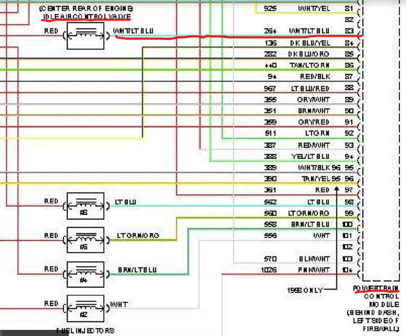

Still had some issues with this car, it would randomly surge RPMs on the freeway or while coasting, then it would surge during idle as well.
Vac leak showed nothing but a small IAC leak, replaced IAC with new Delco one, no change.
Went to the yard and pulled a PCM out of another 97, had stickers all over saying, 'removal of stickers voids warranty'.
Mine out of my car has no stickers, it just has a bar code and 'rkk3', which is the code I assume.
Either way, new to me PCM fixed all my issues, car even feels a little more responsive... Can these PCMs be repaired??
Here is why I decided to change the PCM by the way.... IAC goes directly to the PCM:

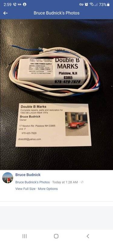

The neon in my 97 has never worked. Recently the one in my 98 with the original ballist doesn't work sometimes. There is a guy that sells replacement ballist if your sure the neon is good.
Thanks Rapple, I did see the ballast as an option, I just feel getting rid of the neon and going with easy to repair and source LEDs is the better long term game.

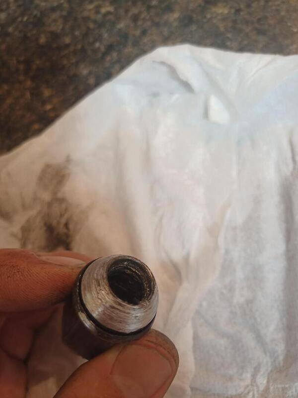

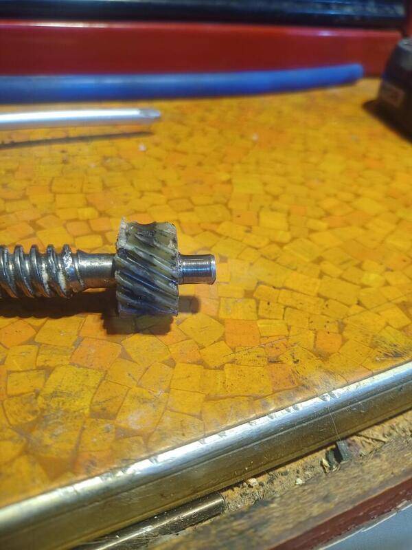

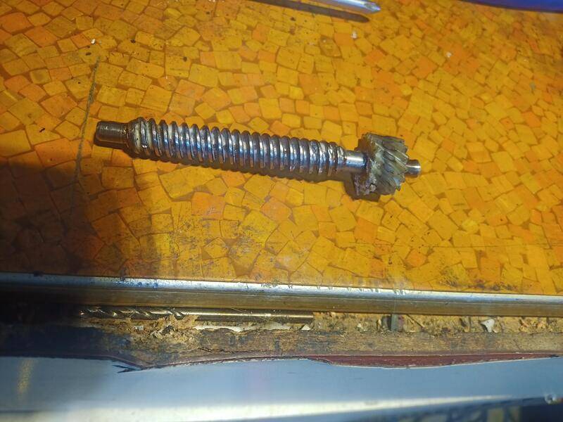

I tore apart the bad seat motors and found the gear responsible for the problem, has anyone tried 3d printing these? Does anyone have a scanner to try and get it scanned and 3d printed??
I am currently having trouble getting it off the metal gear, but I think if we could 3d print a strong version of it you could fix these seats indefinitely... It's a hard plastic running on a metal gear to turn it, eventually the plastic wears out. It's kind of a beast to get to, but there is an opportunity here...
Pic of the worn gear:
