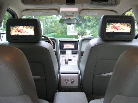

got 2 new head rest monitors for my Lincoln Aviator. doesn't match my factory leather so i'm gonna buy 2 more new head rest monitors from myron and davis. also got a pioneer d1 navigation with the speed sensor hack so i can watch tv while driving. my friends are enjoying the playstation 2 as well..
please feel free to ask any questions about the installs done...

most reputable audio and trim shops sell dye. you can match them for a tenth of the cost.

Just my 2 canadian cents. Hope this helps. The tv's in the headrest look great.
I dyed my headrests. Very simple, actually. I'm an LS owner, and have a graphite interior. Whatever color interior you have, you can easily dye the headrests. The headrests I ordered were a medium dark grey, a stark contrast from my light graphite interior.
You will want to find a local auto body parts shop. NOT Advance Auto, Pep Boys, etc..but the local shop where body shops obtain their supplies.
There are 4 easy steps.
#1. Using masking tape and paper, mask off the actual screens.
#2. Clean the headrests with SEM brand SEM SOAP.
#3. Spray on SEM Vinyl Prep or Bulldog Adhesion Promoter. Let Dry.
#4. Spray on the dye. Let Dry. Repeat. Let Dry. Repeat.
If you cant find SEM locally, here is a link:
http://www.tcpglobal.com/autobodydepot/specialty.aspx?gclid=CLK7k7PM5YgCFTaVFQoddh3KoQ
Trust me. If you do it right...taking your time, it works perfectly. Especially for headrests which generally don't take a constant rubbing like a seat bolster. SEM has a TON of colors...one of them will be close enough to match your interior.
