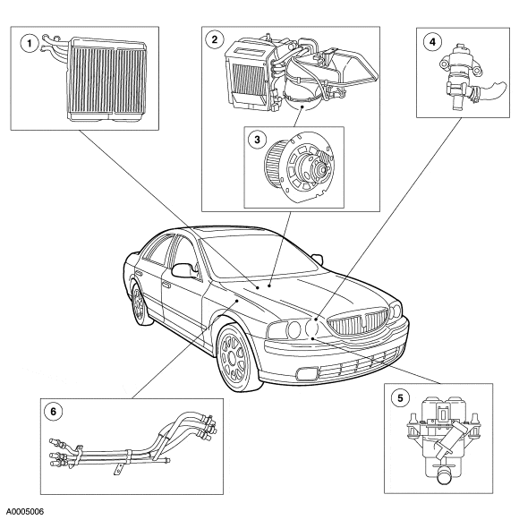

The Dual Automatic Temperature Control (DATC) commands the Dual Coolant Control Valve (DCCV) to allow for more or less hot heated coolant to enter the heater core.
more: http://www.lincolnvscadillac.com/fo...ck-it!&p=2037340396&viewfull=1#post2037340396
#5 is the Dual Coolant Control Valve P/N 18495
#1 in this ^ illustration
